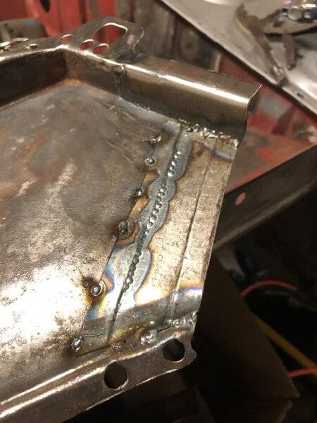

Thanks for checking in! It’s been super slow through the holiday. Now I’m getting ready to get back at it! I’ve been working on the upper cowl section. Hopefully I can finish up the welding repairs on that tomorrow. Hope to post some fresh pics soon.

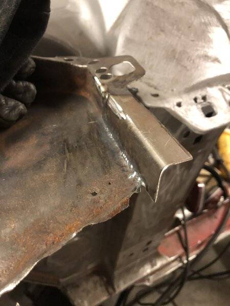

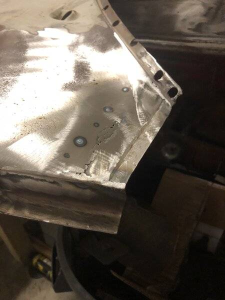

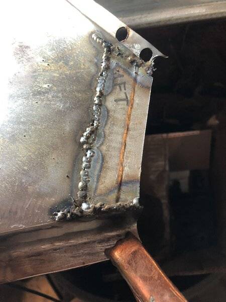

A little progress on the upper cowl repairs. Got most of it done now. One little section left then I’ll sand blast the whole thing.

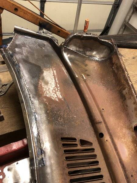

Finally got the final repair section done. Upper cowl sheet metal repair now complete! I’m going to blast and epoxy prime it next.

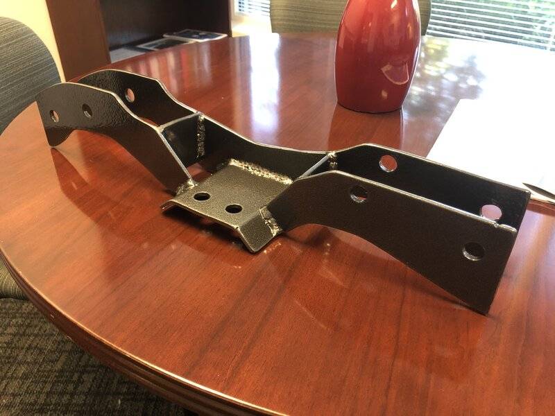

I also sent my trans crossmember for powder coat. I didn’t care too much what color it was and a buddy of mine was getting a bunch of stuff done. I just added it to his batch. It’ll be a silver gray color. Can’t wait to see it!

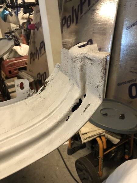

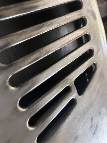

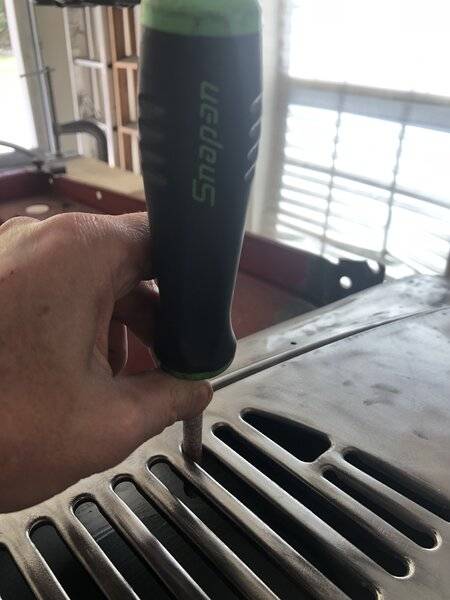

This thing has taken forever! I think I got it all ready for primer now though. Getting in those grill slots was a serious pain. Tedious sanding with 100 grit wrapped around a screw driver worked pretty well. They say it’s all in the prep...
I know it's too late now, but how do you seal and paint under those vents? There's always that somebody who notices that at a show and I wouldn't want it to rust. I once had the thought of under coating it.

@Dave Lucas , the cowl isn’t welded on yet. It’s getting epoxy primed on both sides first. So it will be protected for sure. Top of the bottom cowl has rust bullet on it. I’ll detail that more when I get ready to permanently attach the upper cowl section.

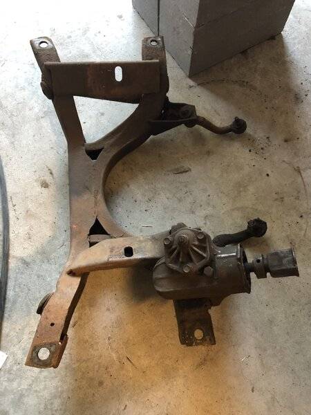

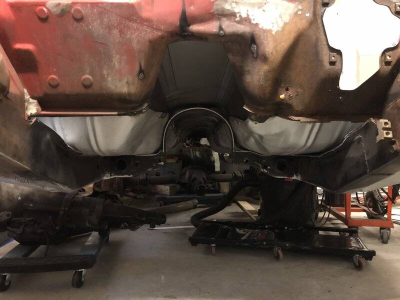

Got the motor and trans back out of the car. Now I can finish up the floor and transmission tunnel from underneath. I also dropped the K frame, which I plan to beef up just a little.

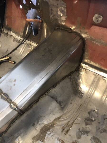

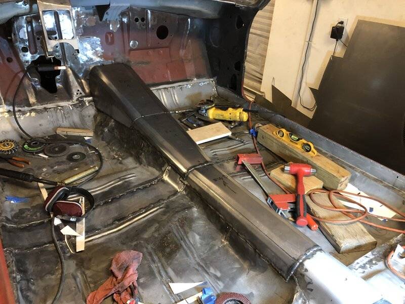

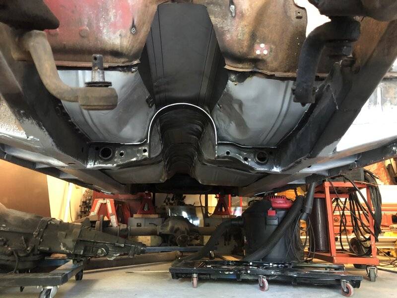

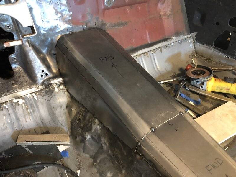

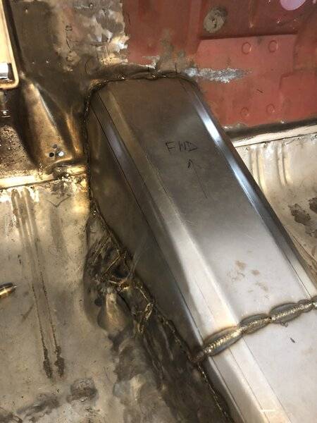

Got the rest of the top of the tunnel and floor burned in. Just a little stitching to do from the bottom. Back is killing me now so that’s it for today.
good job :thumbsup:, are you going to make infill panels between the new tunnel and new trans' hoop? it'd probably stiffen it a bunch.
neil.
I don’t think so. I have the floor welded to the hoop in a couple spots though.
Got my homemade transmission crossmember back from powder coat. Love it. My first part that’s ready for final assembly! Too bad it won’t get installed for quite some time yet.

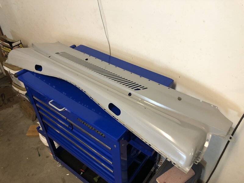

Just in! Got the upper cowl epoxy primed. It’s motivating to see color and even just primer go on some parts.

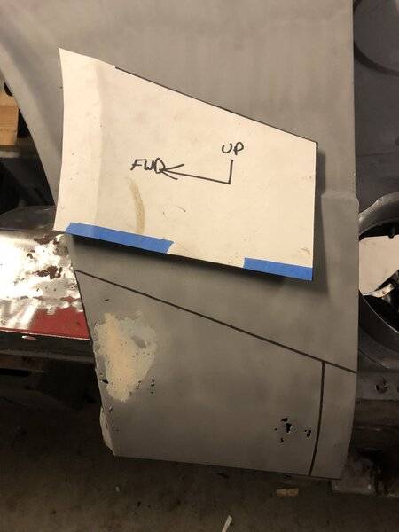

Finally starting work on the fenders now. Got them back from the blaster. Got some homework now.
Maybe this is boring but I like pics so here’s some more. Started working the left side fender.
