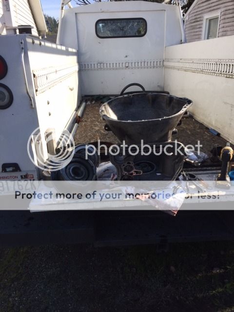

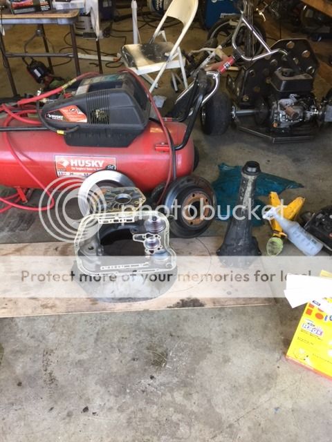

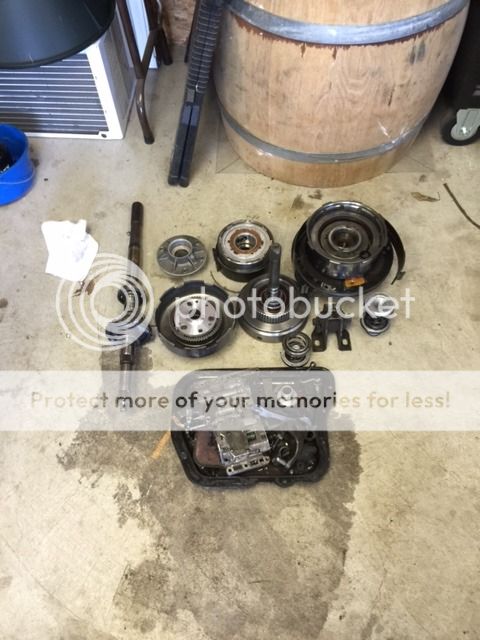

I am starting to prep my new 727 trans case for the next season of street/strip duty. I have some parts on the way but have only dis assembled the trans and started dressing the case inside and out.
here are the pics of disassmebly.

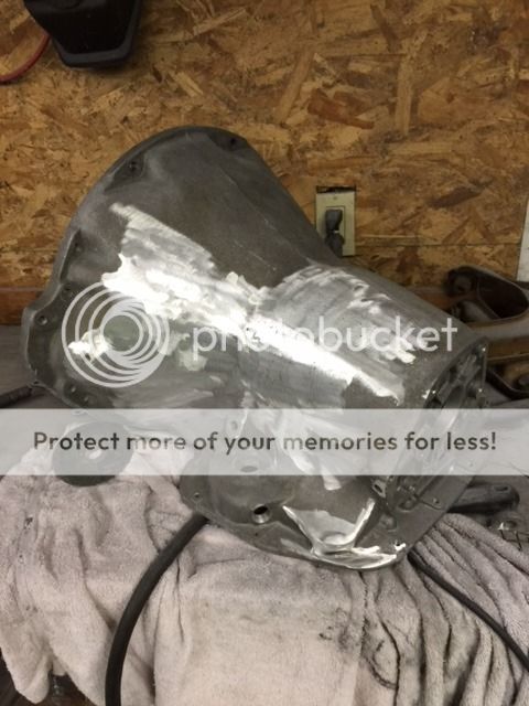

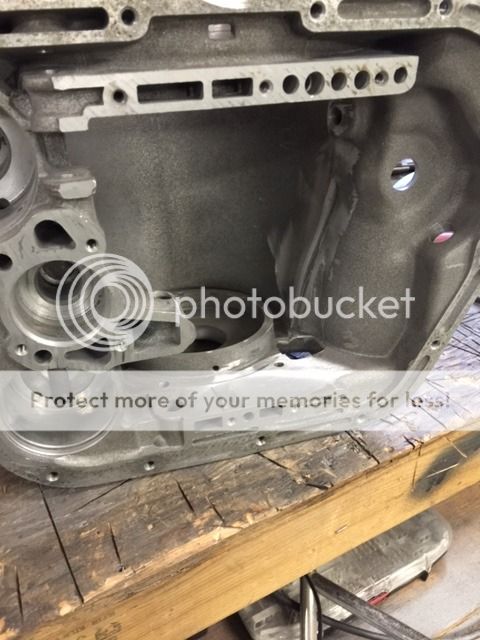

once i had the trans all apart i started the cleaning process. i also deburred all the casting marks on the inside of the case.
then i moved to the outside of the case. i will be running a full manual valve body with an aftermarket cable shifter so i got rid of all the un needed mounting points.
then i started to smooth, blend and clean up the outside of the case

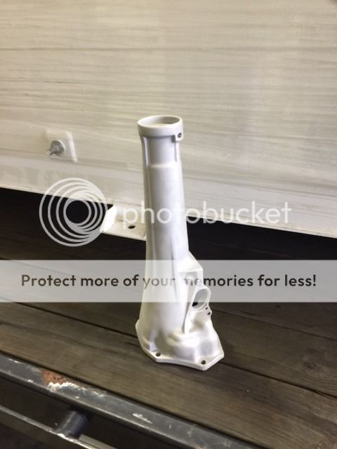

here is the tail shaft done and ready for paint.

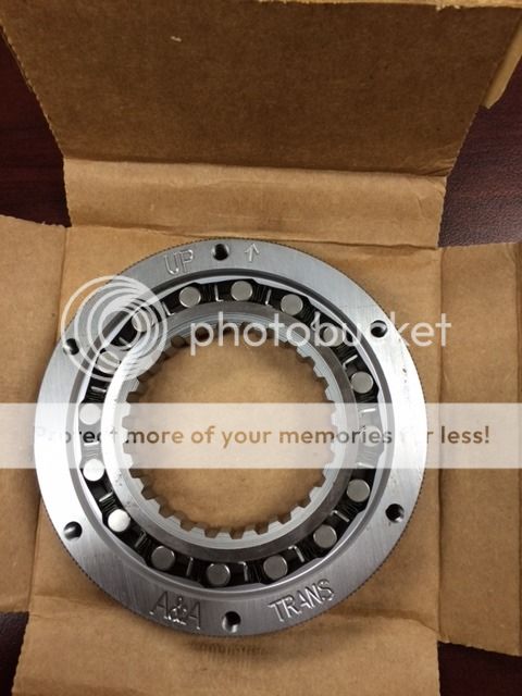

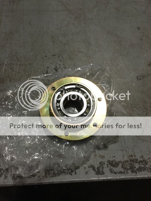

first after market part that i consider mandatory.
bolt in sprag. this one is from A&A transmission. it takes 6 bolts and also has 16 rollers vs the factory 12.

Hey younggun, I've been meaning to ask you what you get with a 16 roller sprag over the 12 roller factory sprag? Wouldn't you get more friction and heat? Or are the 4 extra rollers not significant in the heat department. Basically, what are the plusses and the minuses? I don't know squat about transmissions. Thanks in advance.
I think more rollers help distribute the load over well...more rollers making it stronger.

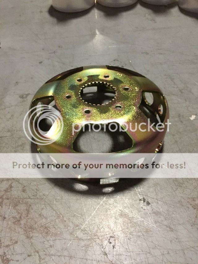

got my steel sleeved billet aluminum drum! super light weight and still streetable!

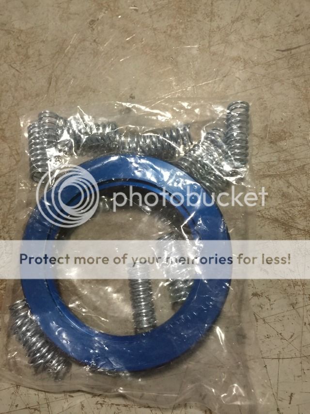

got my billet spring retainer and 15 springs

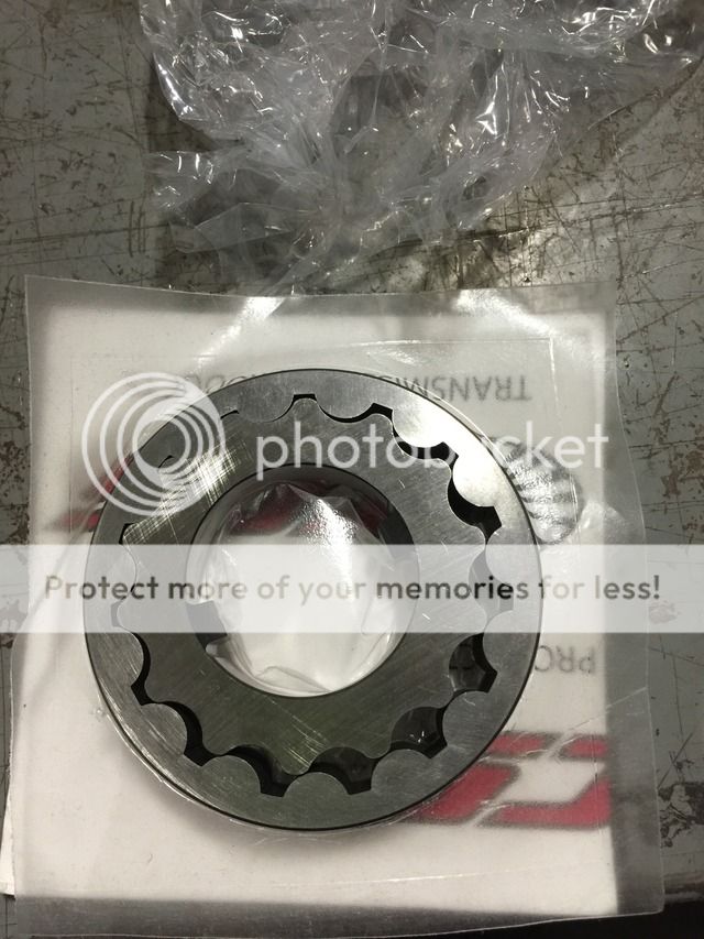

got a max lug pump gear set. has larger converter lugs machined in.

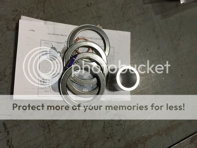

rear roller support

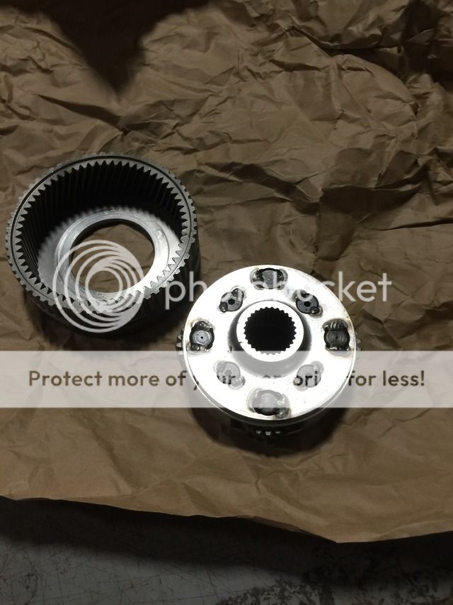

fully rollerized rear planetary set up with governer delete

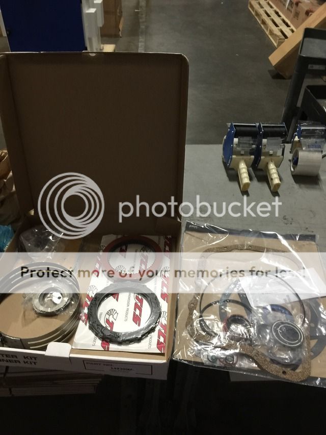

and rebuild kit with kolene steels and red clutches, kevlar band.
