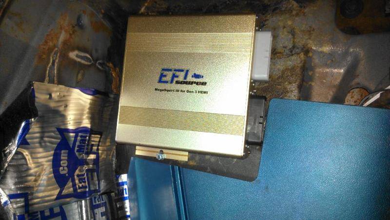

I mounted my Gold Box here:
But the plug ins are at the top.
