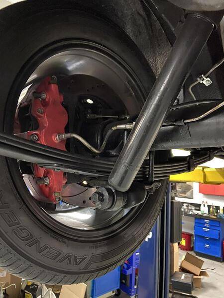

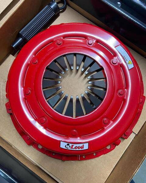

I'll blab some more with these photos from last week. Still waiting on new photos to come in.
Old tranny out. I was able to sell it along with the center console.
Before all the cutting began
I think I already posted this one
Don't know why they sent me this but oh well
Hello my pretty!
Well hell I guess that's better than nuthin. lol
