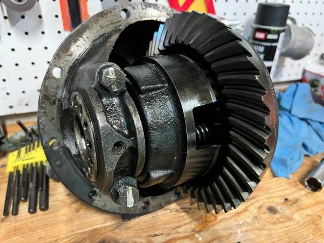

Not yet. It was supposed to ready to go last Friday. The tech took it for a test drive and the differential started making noises that you never want to hear. Turns out the pin was working itself loose. So I had the shop order a new differential. Should be installed this week and hopefully I'll get the car on Friday.
At least now I know what the cause of the "whining noise" I heard before I dropped the car off was from.
Pic of the damage.

Yikes. Glad they caught it early before delivering it. Keep us updated once you get it back. Curious to see how this thing feels on the road.

I got the car back today and drove it about 12 miles. First thing I noticed was that I love how the Tremec TKX shifts. Very precise and smooth. However, I’m having an issue with the rear end. The car wants to “hop” a bit on tight turns. Also, the rear end feels too loose if I get on the gas a bit. I’m not even doing full throttle runs yet until the clutch and rear end are broken in. I had the shop put in 1” lowering blocks during the rear end rebuild as well as welding subframe connectors to stiffen up the car. I’ll pull the lowering blocks first to see if that solves the problem but my feeling is that it’s something else going on.
Hmm. Weird. Any vibrations, howling or wines? Wonder if the blocks are loose? Removing them could narrow things down any way.
If something was loose at the diff I would think there would be noise going down the road?
Hopefully it's a simple. Maybe something in the differential is sticking?

What kind of sure grip? A clutch or cone unit? Either way, you will benefit from finding a large open parking lot and doing a series of figure 8s. That will break in the clutches or cones. If it's a new unit, it will be very tight until it's broken in. In a light car like an A body, it will drag a tire a little around a turn.

Hopefully it's just the cone in the differential sticking a bit. I'm going to take it out for a longer ride today and see if frees up a bit. I'll try what Rusty (see above post) recommends. No howling or other noise.

I'll have to ask the shop what they ordered. My old differential was a cone type (I think because I can see the springs). The new one is a brand new unit. This is the only photo I have of it before it was installed. Maybe someone can tell by the pic?

Your new one is a clutch type (powr-lok). It's a very good unit. It probably just needs more miles on it so gear oil can circulate through it. I hope they used some sort of friction modifier.
Power lock. Nice diff. Have one in my dart and an old Ford pickup. The one in the pickup was set up tight and will chirp the tires in a sharp turn with very little gas applied.
The power lock type diff is more aggressive than the cone type I believe. Also the most preferred.

I drove the car today about 40 miles. The rear end feels a lot better. No skipping or jumping. You guys were right about the clutches needing a little break in time. I do notice now a bit of "howling" from the rear end when I give it gas that goes away when I let off the throttle. Hopefully it's just the gears getting broken in.

Howling is incorrect pinion gear depth. Tell them about it now. If it goes on like that, you will not be able to get rid of the noise.
