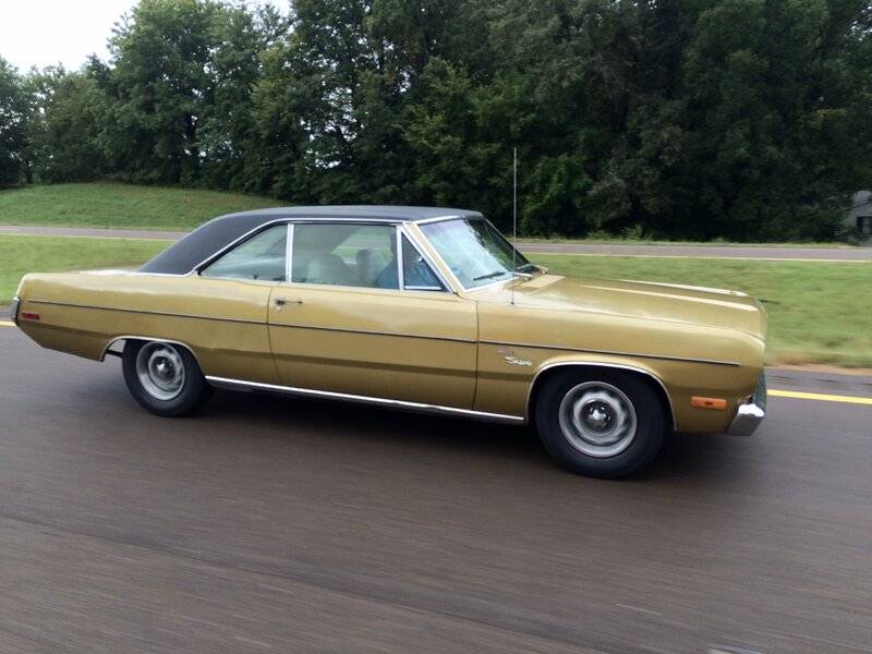

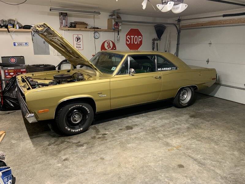

Hi everyone. Been a member for a long time, been helped by a lot of you on here, but I’ve not really posted on here to share the whole story of my 72 Scamp. I got it in June of 2004 when I was 14. It was my first car and I’m proud to say I still have my first! It had been painted the year prior to me buying and came with a nice original interior. The car had a 318 that was burning oil, needed bumpers, an engine rebuild, and some maintenance. Was a great place to start and it’s been an adventure!

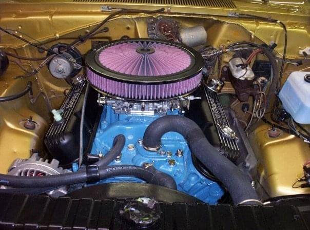

First thing I did were the bumpers and swapping to electronic ignition. After that I wanted a 4 barrel so my dad suggested pulling the heads “just to check,” knowing full well that the 318 was needing rebuilt. This resulted in pulling the engine, boring it .030, cam, 4 bbl, and redoing the heads. Had I known what I know now, it would have gotten 302 heads. Oh well. What was the internet back then anyway?
After the rebuild, the tranny blew as my dad didn’t hook up the kickdown. Rebuilt the 904 with a stall and shift kit and dad paid for that one .
The car ran 16.3s stock, 16.1s with ignition. Engine rebuild I ran it the day before the tranny finally went and it went 15.2 with having to let off and ease in during shifting. After the tranny it’s been 15.4s (2.76 gears and the stall don’t go well).
After college the car sat for a little bit as I got married and had kids. Was able to keep it on the road somewhat, just doing maintenance.

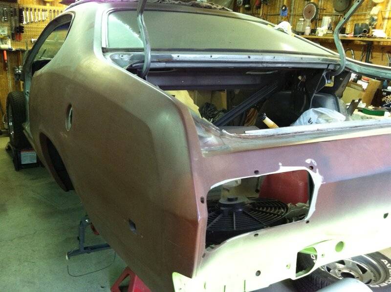

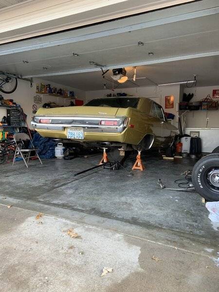

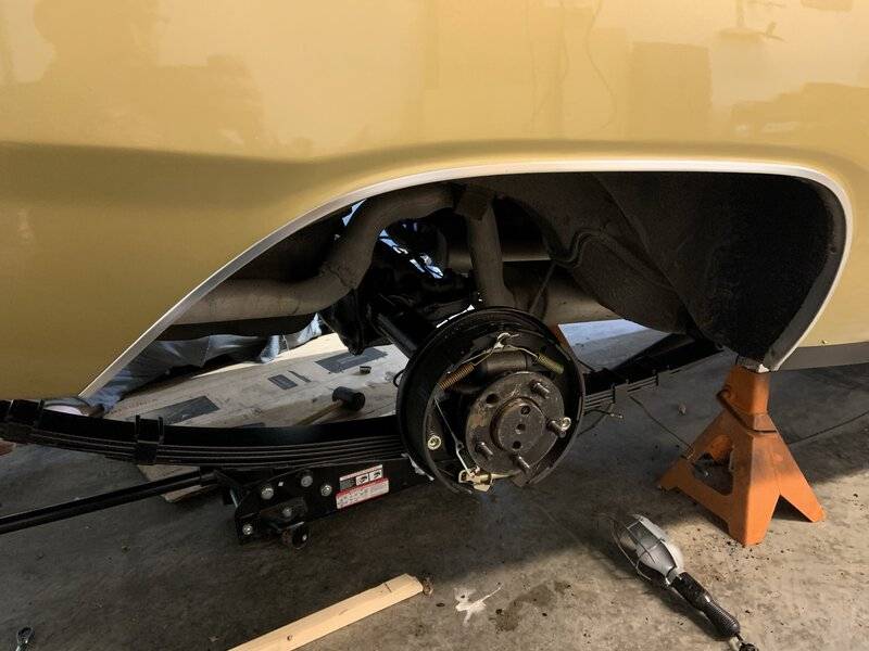

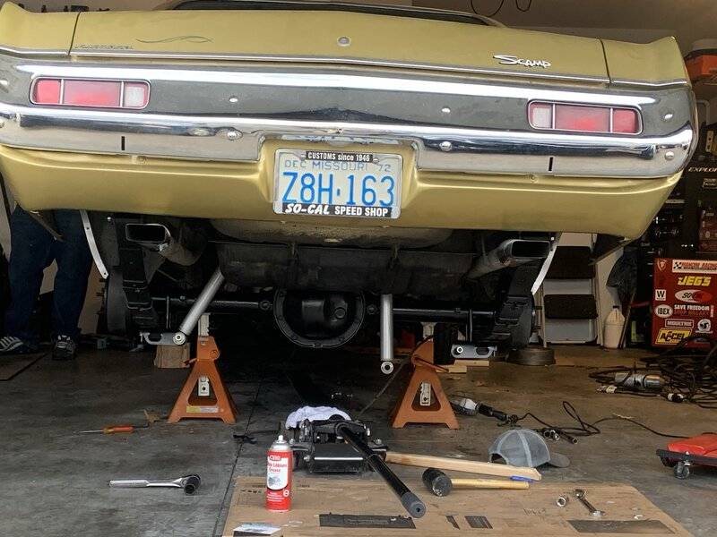

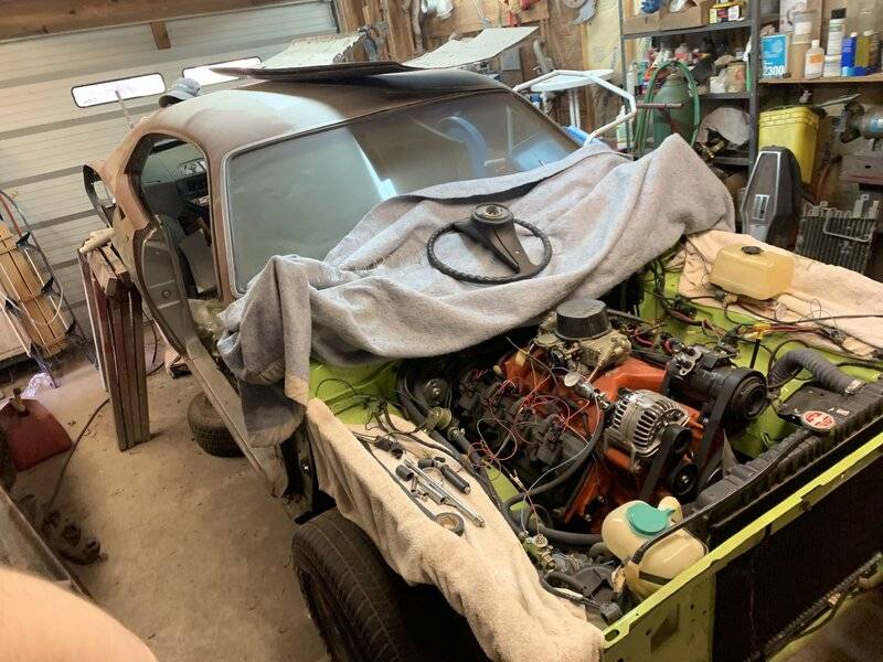

Last few years I’ve really gotten back into working on the car. I redid the brakes, power steering, wiring harness, had the front seat backs redone, rebuilt the front suspension, and this spring redid the back end and swapped in an 8.25 with 3.92s and SG.
Other than the rear end, most of the restoring has been to stock or similar. I have just had a desire of keeping it on the road, rather than keeping it down longer to upgrade. Part of that is just having kids and other priorities, and wanting to use the car to create memories more than wanting to have the nicest and fastest car at the cruise night.
The car originally came with a/c. I yanked out the a/c in high school during the engine build (you know, 10 hp is important). I pulled the heater stuff out when I redid the harness. The heater box needs to be completely gone through, so again, a project for later down the road. I don’t drive the car in the winter, so no big deal for now. Plus, one of our friendly fabo members sold me a dash bezel for a car with no heat or a/c. What’s not to like?!
The car lives in Mid MO and has made trips under its own power to Kansas City, Indiana, and most recently to SeMo, when the parking brake became engaged on the highway, ruining the rear brakes. I limped it the last 70 miles with only the front brakes available as well as no power steering . This ultimately led to the rear end replacement I just completed a few weeks ago.
Going from 2.76 Scamp to 3.92s I think I’m done with the long trips but I’m excited to engage in a stop light battle from time to time. Will post pics mostly in order showing the whole process. Thanks for reading and God bless!

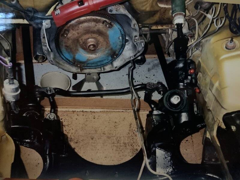

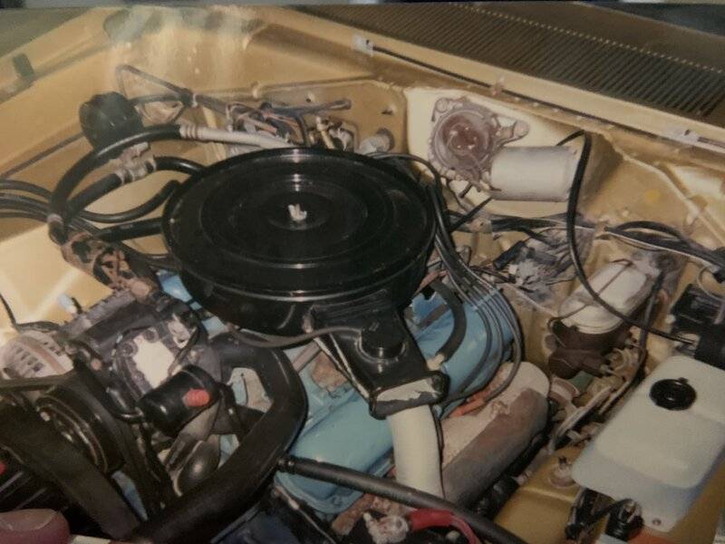

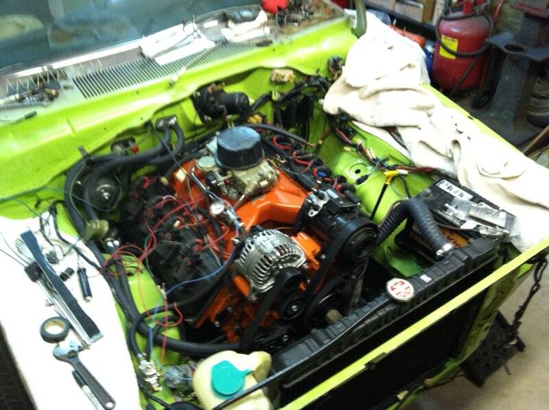

Pics of my first ever burnout. Had to practice in the parking lot before I did it in front of people at the track lol. Few pics of the engine swap, my kids helping out, as well as me and my dad at a show. He’s got a Road Runner which puts my car to shame. His OCD really helped a lot when I was impatient in high school.

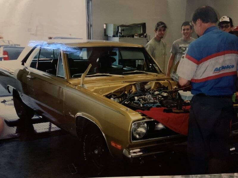

Car hit the dyno and made 200 hp and 240 tq. Not bad for a 318 car with stock heads and manifolds. Few pics from over the years that I enjoyed. Couldn’t find any pics of the rebuilding of the suspension but you can see the end product.

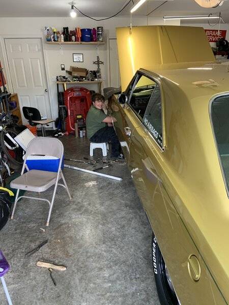

More adventures along the way. Help from the boys. I took the car to my in-laws for a hunting trip, which is when the rear end finally took a dump lol. Also a pic with my dad’s road runner.
Covid cruising with my nephew the werewolf . Rear ended swap pics, and pics with my buddy who has been a giant help along the years. Also pic in front of my old high school and college.

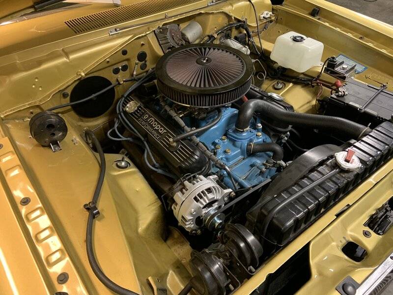

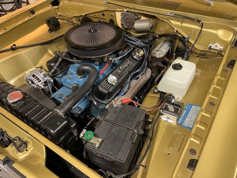

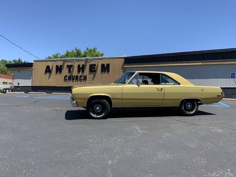

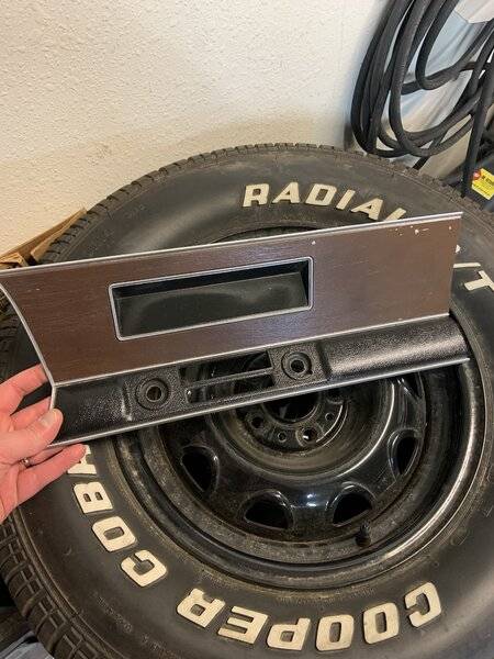

More up to date pics. Current engine bay with no heat or ac. Old pic from wedding day. Also the bezel I need to restore.
All started with Mopar collectors guide as a kid. With the rear end swap to bbp, I am running these silver rallye wheels till I can get them black. Had I known the rear end would come soon I would have done bbp discs on front. Live and learn. It’s been a fun hobby over the years. God’s been good and my wife has been patient . Thanks for reading.

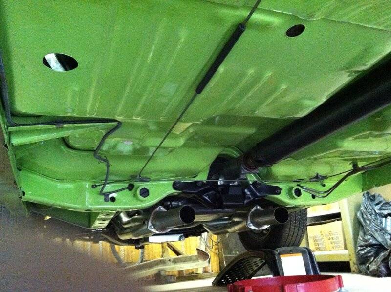

Something will have to go completely sideways for me to get rid of it now... I spend days under that thing scraping undercoating and sandblasting the bottom. View attachment 1715721668View attachment 1715721669

Thanks!! We spent hours on that undercoating... Just leave it all under there and black it out for a driver!! Wish so badly I would have... Might be done with it!! First we tried soaking it through the week with diesel fuel and scraping but eventually just heated it with a bottle torch and scrapped along. Then came the sandblasting laying on our backs. What rotisserie?!? Lol I was pleased with everything then and I’m still happy with it but it’s been just like this for over 8yrs...
