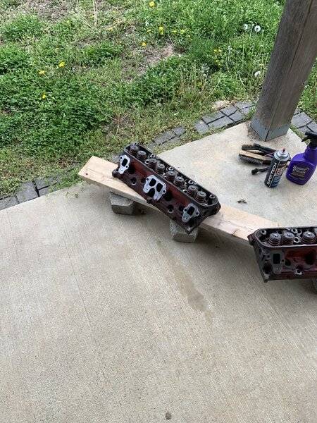

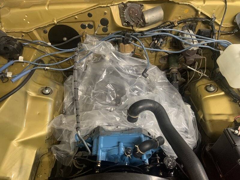

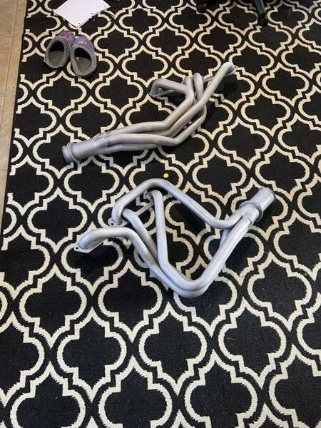

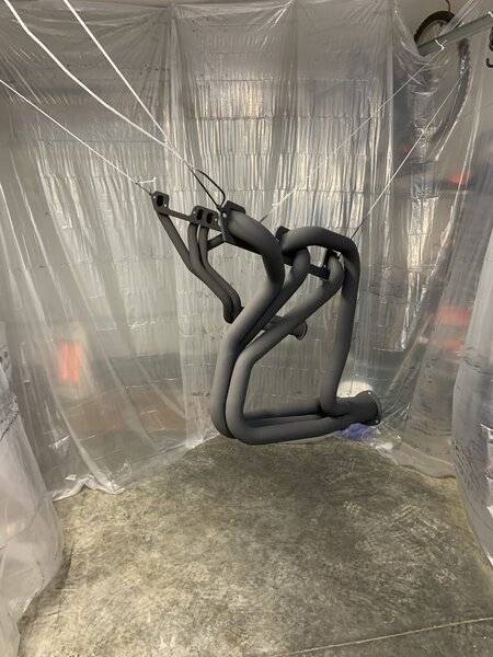

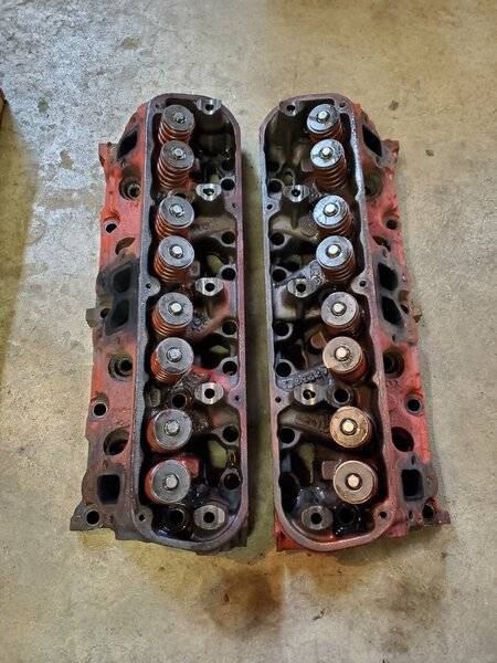

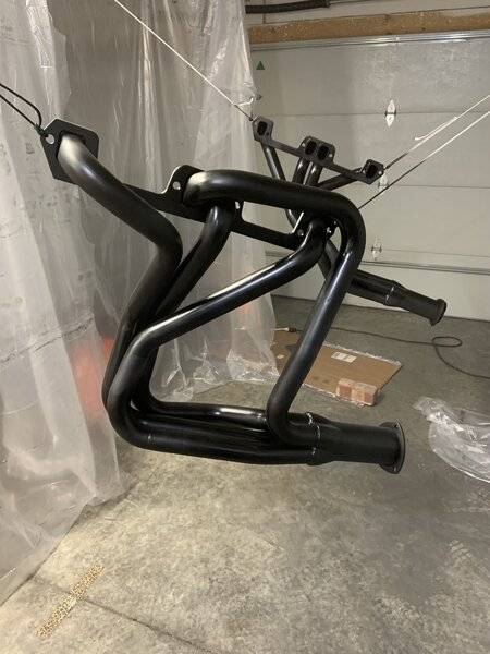

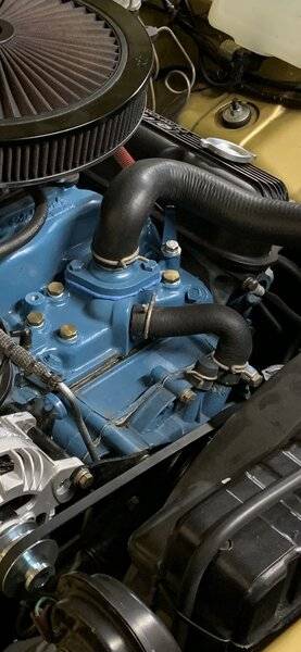

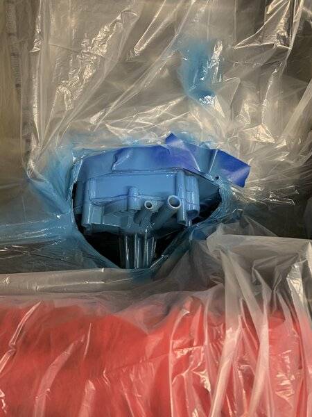

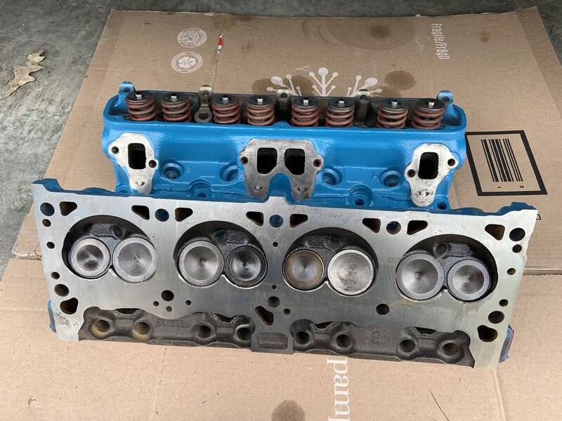

Picked up the 302 heads. They’ve been lightly ported and 1.88/1.60 valves put in. I plan to port a little more and put in new springs and send em. Got the headers back from the sandblaster and went ahead with VHT header paint in flat black and sprayed some VHT satin clear to give it a light sheen. Got the top of the water pump, housing and front of block touched up. Didn’t mask as well as I should have so I have some cleaning up to do. Finding the balance on where to stop is always tough lol. I like to do things once and do them right. But also know you can get carried away and never get it back together. Really hoping heads headers and the port work will wake this 318 up some more.

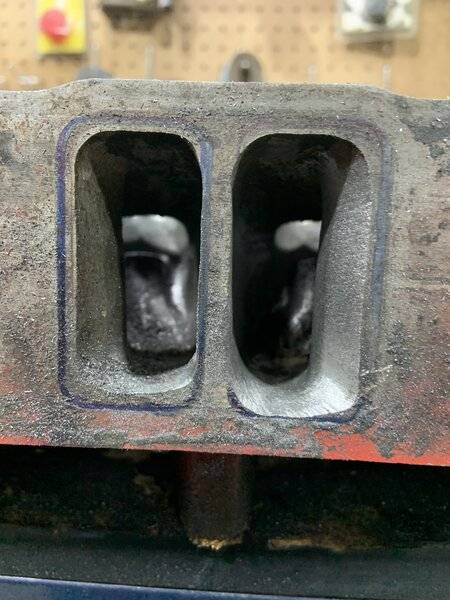

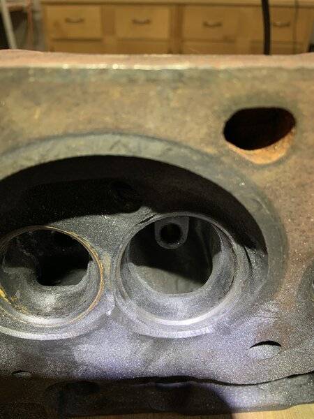

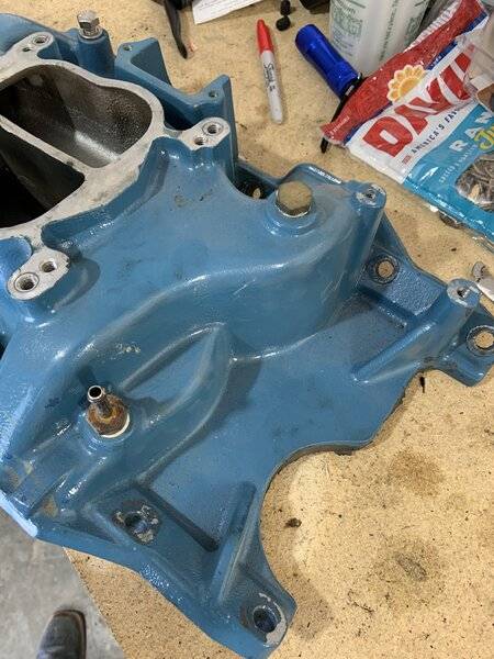

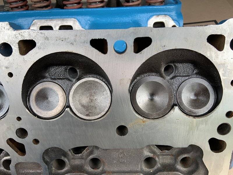

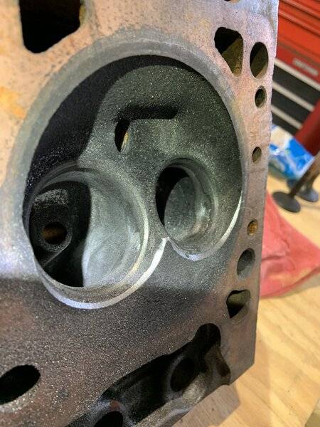

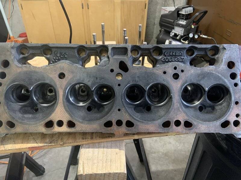

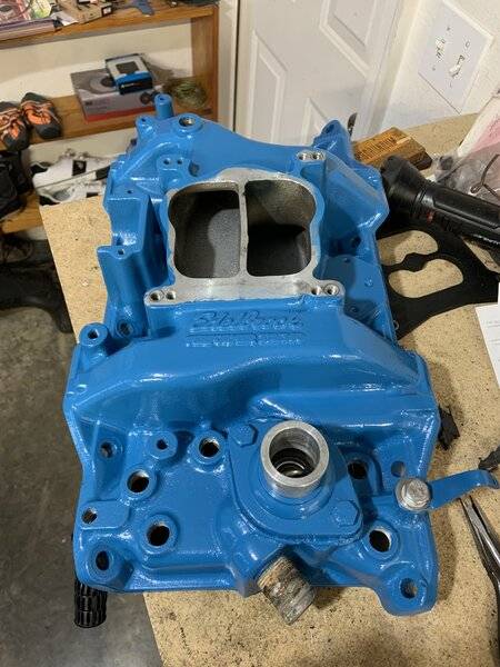

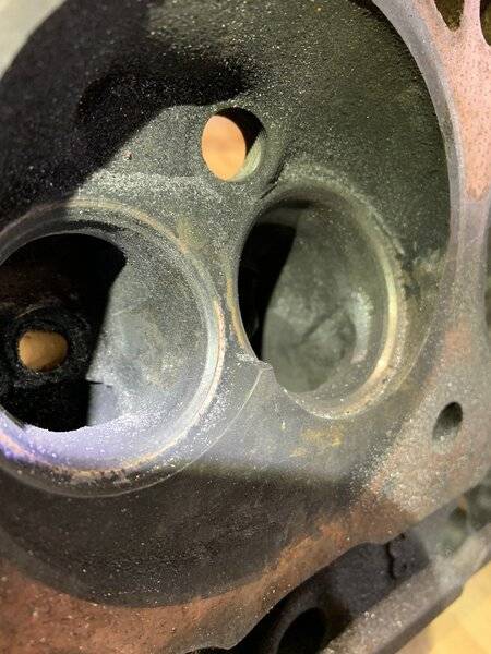

Did some port work on the 302 heads with the guidance of some friendly folks on this page! Didn’t get too crazy on it but made a lot more room. Blended the bowls some. Ported my intake just a little. It’s the performer intake which tapers at the end of the ports. I basically removed the taper. More pics to upload shortly.

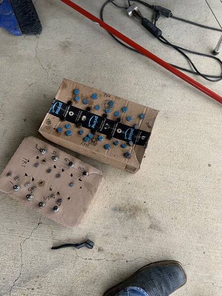

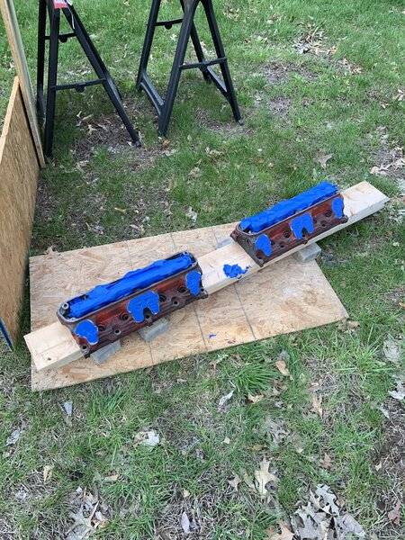

Ended up having to have a valve job done. So had 3 angles done. Guides were good. New seals. I was able to reuse the springs so I was happy about that. Picked the heads up today.

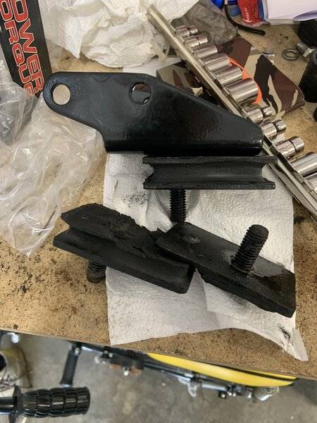

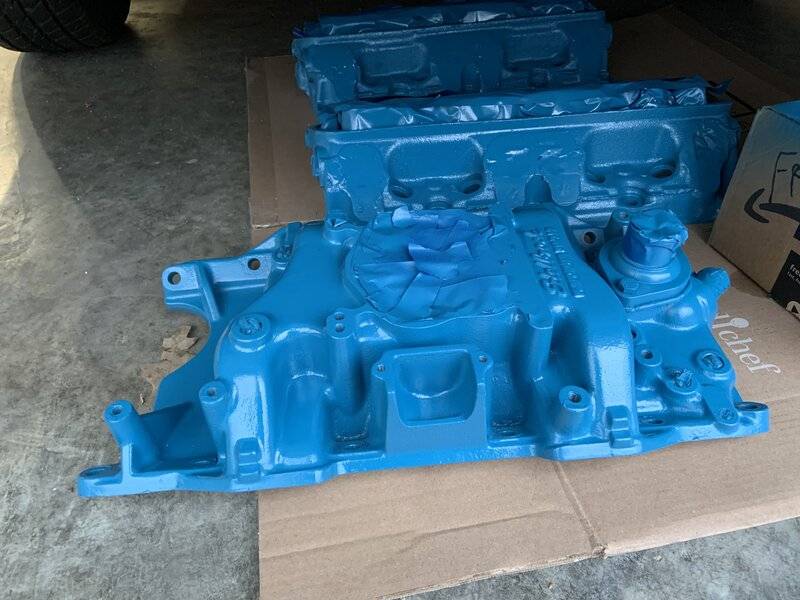

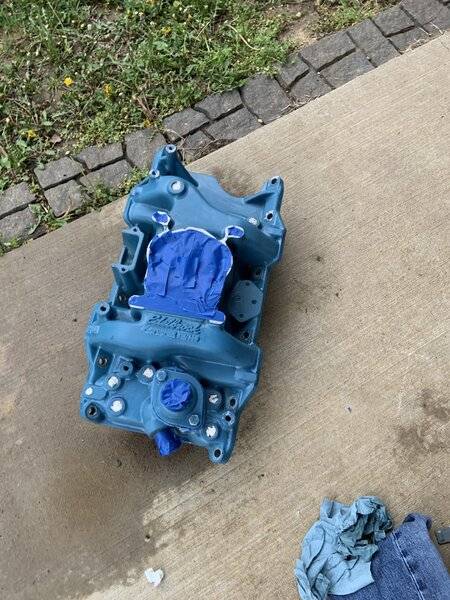

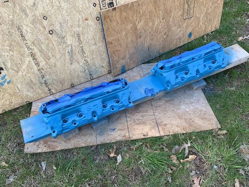

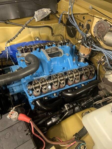

A little before and after paint. Got the heads, intake, and bolts painted just as it started to sprinkle. Friend with a Mopar 10 Challenger came over to learn some stuff. He’s new to wrenching so I’m working on roping in another addict lol. Hoping to get my headers installed shortly then will work on getting the top end on.

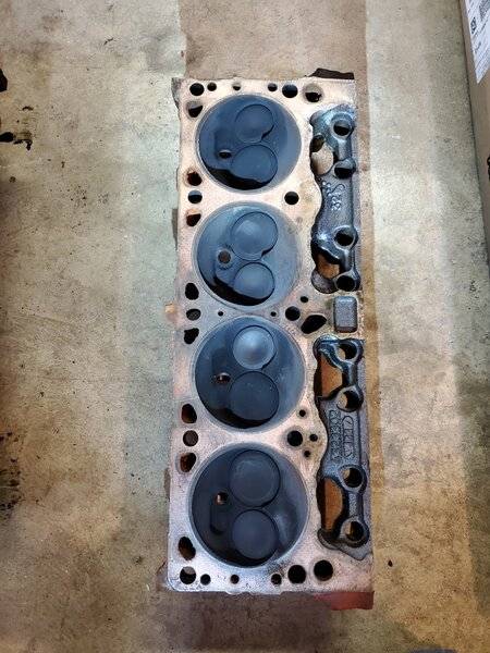

So before project: factory small valve heads. Performer intake. Exhaust manifolds.
After project: 302 heads with 1.88/1.60 valves. Ported. Intake lightly ported. Headers. Might swap from 600 eddy to 650 Holley. Thanks for following!

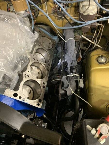

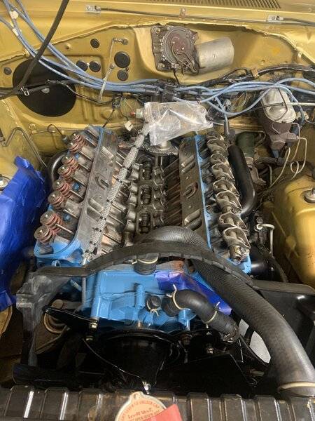

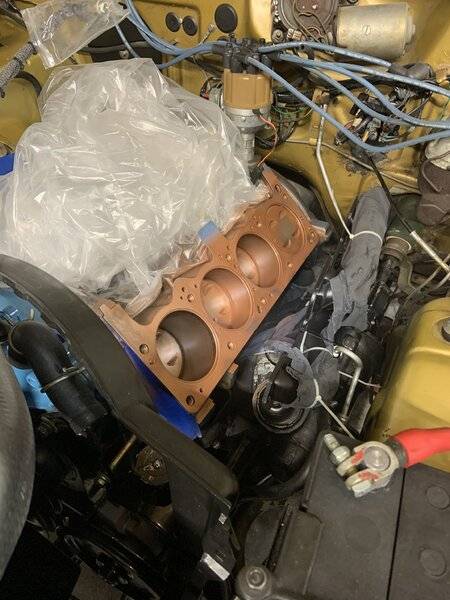

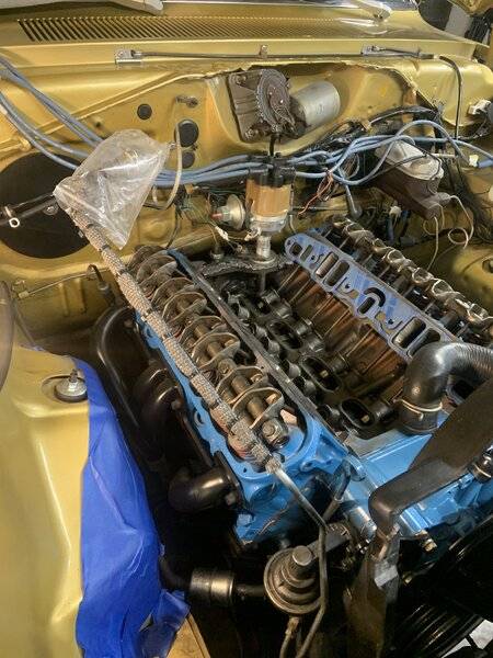

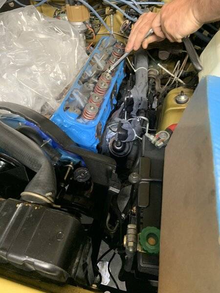

Got the heads bolted down and the headers in. Man headers are a pain! Had a friend help me on this one. Scratched up the paint a little but not too bad. Zero dents put in! Gotta hook up my 90* oil adapter and wire my starter and I’ll be basically done underneath. Hoping to have the car on the road in the next week or two depending on time and if the exhaust shop can get me in.

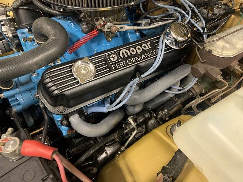

Finally got it fired up! Ran into some issues with manifold Fitment. I think these 302 heads may have been milled a little. We wallered (redneck word) out the holes a little and got it to bolt down and seal. Fired it up open headers. Man it was a blast. Did a quick tune and brought it out for local cruise night. It’s funny you roll in uncapped and everyone notices. The vht paint did not hold up well as you can see in the pics. Will try brush on bbq paint next. Someday I’ll Cerakote them I think.
Car needs a little more timing and probably a little bigger carb. Traction became an issue for the first time ever so that’s fun. No leaks. Debating on adding some cutouts just for fun. Glad to finally have the car going again.

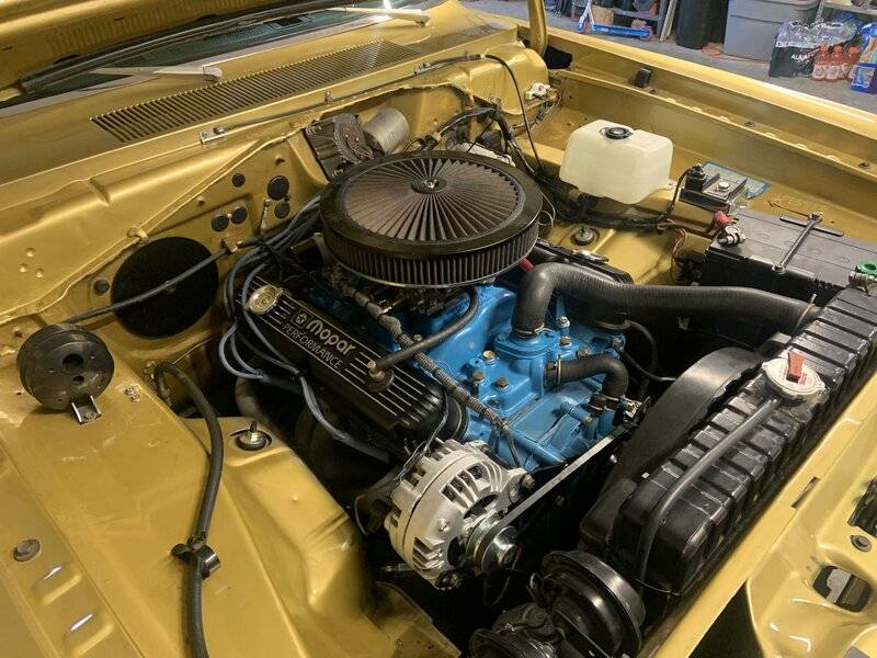

For anyone interested, HUGE difference going from rebuilt factory heads and manifolds to ported 302s and headers. Whole different animal. Need to do some detail work but it runs again. Very happy.
