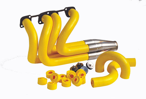

Where did you buy the mandrel bends?
These work nice
http://www.icengineworks.com/
02cd2a_e1ec729474f740adb2b3fa1931a12af4.jpg_srz_p_600_407_75_22_0.50_1.20_0.00_jpg_srz
Tubular Automotive also has "make your own" kits in numerous sizes. You can ask them to include some connector pieces (a 2" OD pipe will take a 1 7/8" OD connector or slip piece) and you can put them together without having to weld them in place for the layout. Tubular Automotive is in Mass. at 781-878-9875
