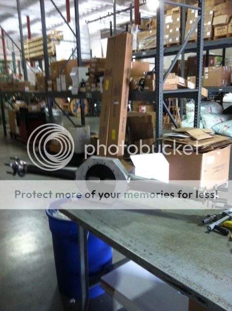

i have been busting my *** working 60-70hr weeks saving up for this bad *** rear. just got it in mail today. moser 8-3/4 fab housing with back brace and star flange axels. 1" narrower than stock. just gotta mock it up and set pinion angle and weld on the perches then its off to powder coat!
gonna do gloss black. the rest of my suspension parts are coated gloss black already so it seems kind of fitting. this set up was actually pretty fairly priced. it is super stout, thats for sure!

I Have wanted one for a long time. i had a back brace welded onto my stock housing and was told it would be done with a jig. well it wasn't. it pulled back both axel tubes 1/2" each. this set up was 1400 to my door. thats axels, housing, back brace, star flanges, studded everywhere and new bearing installed. oh and thread in wheel studs. by time i got all new crap for another stock housing i would be into it for almost as much. my car will never see a trans break or a 4-speed so i dont think i will ever hurt this thing. hope to put the car into the tens eventually. should be all i ever need.
