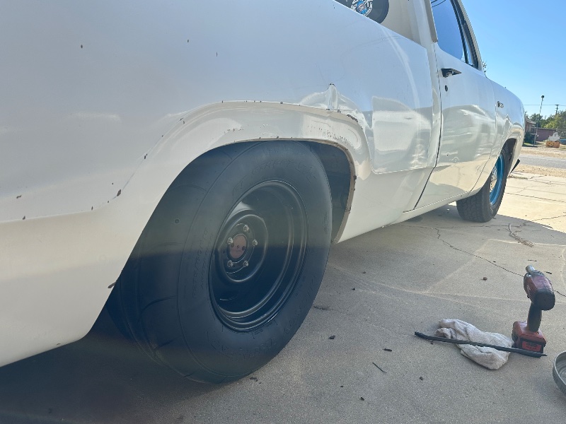

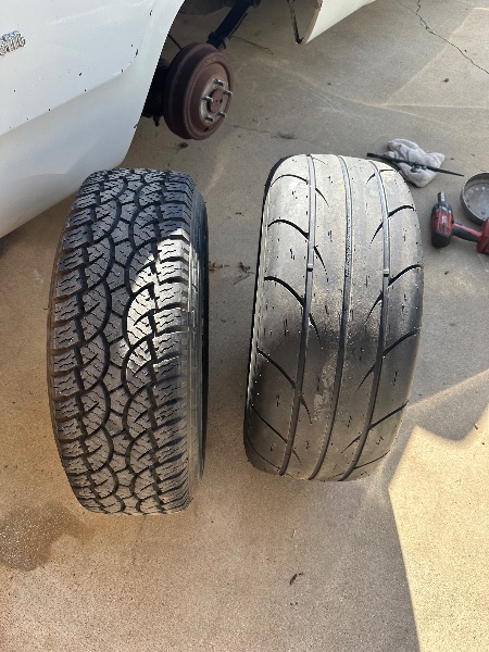

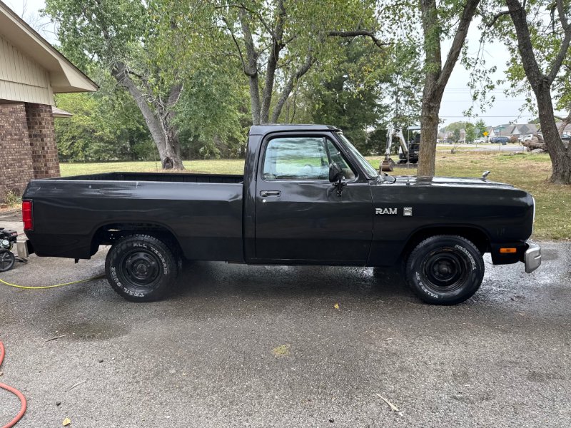

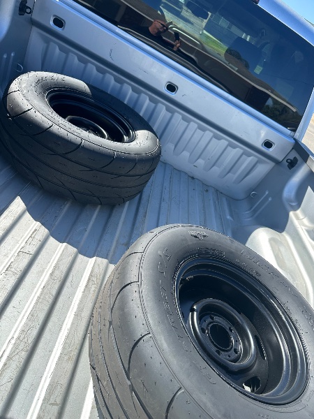

While it’s cool to do burnouts rolling down the road at 40mph it certainly does not a fast truck make. So, we have some power, it’s time for some traction before we head to Tucson and try to make passes in this thing. Ordered some 15x8 cop wheels from Wheel Vintiques, and a set of sticky Mickey’s. 275/60-15 ET street SS to be exact. I’m surprised by how well the truck hooks now. The suspension is just stock garbage lowered a bit and it seems to work really well.

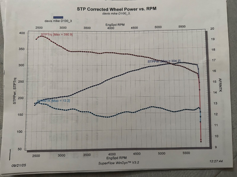

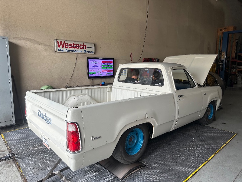

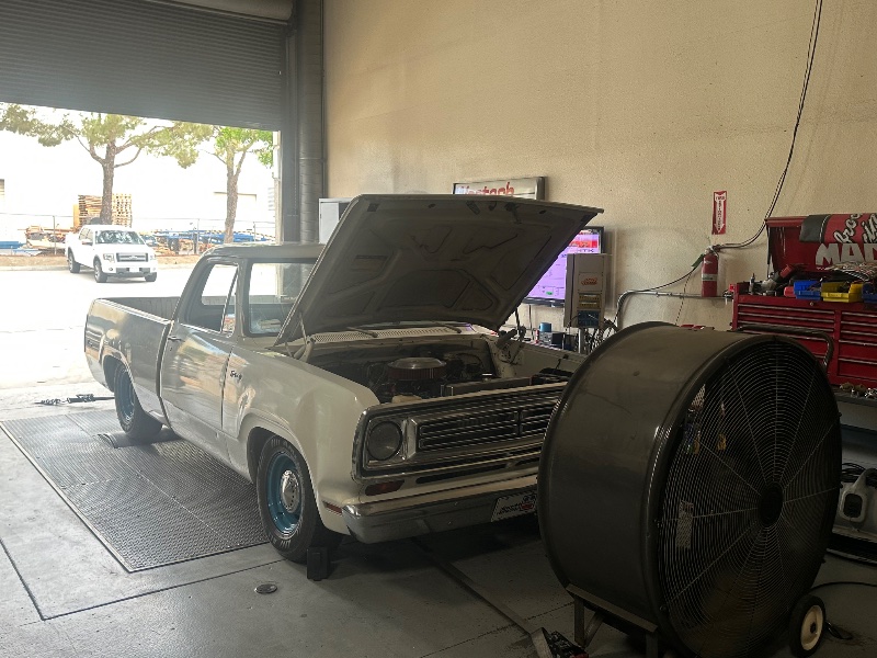

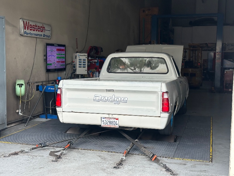

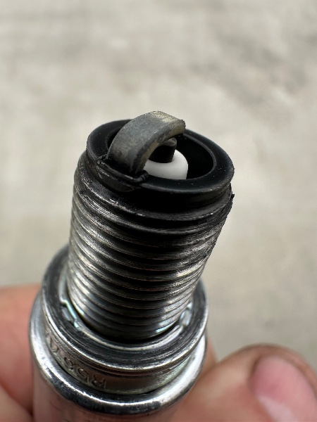

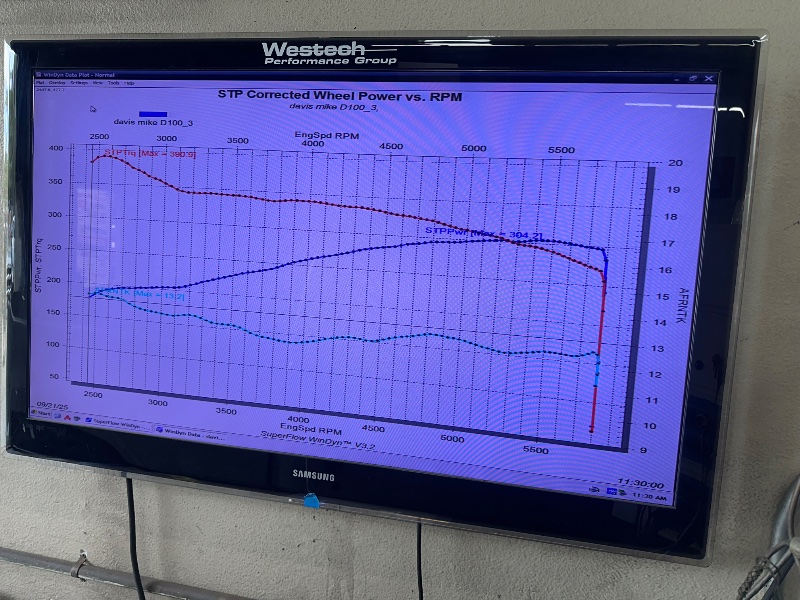

Today was good day fellas. There are no hot oily magnum parts on the floor of the dyno so everything else is a bonus. We tugged on this thing more than a few times and it never complained. We made a few soft tuning pulls and it kept picking up power with more fuel so we kept throwing fuel at it. Ran it at 34 degrees for all of the NA runs and the plugs looked awesome. I am extreme happy with this little 300 crate engine . This thing was on the engine dyno about 3 years ago in this configuration, 212 comp cam, rpm air gap, 750dp, and made 365hp to the crank. Today it made 304hp and 390lb/ft to the tire. That’s about 50 more than I expected. Then we sprayed with 100 shot and it picked up a bunch. 388hp and 427lb/ft. It’s a little fat on the n20, down around 10:1 afr so it could pick up a bit more pulling some fuel jet out of the plate but I couldn’t be happier. I’ll tune it a little more on the track in Tucson in a month and dial it in a little better. All in all, a very good dyno day. The one pic I took of the plug was after two nitrous pulls.

Congrats, you must be tickled with that.plugs look very good.

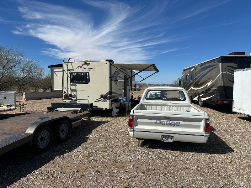

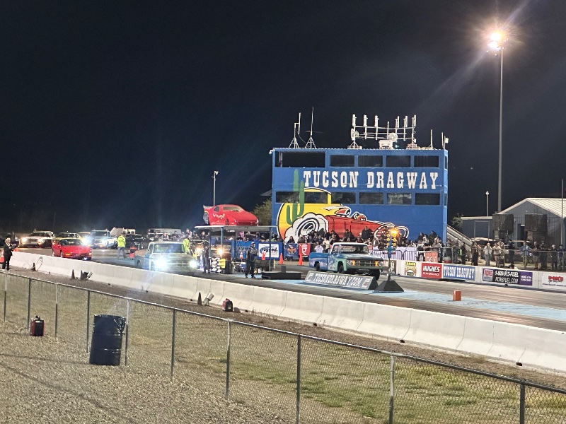

So this weekend as some of you know from multiple other threads, we hitched up the trailer to the Ol motor coach and headed to Tucson for the duct tape drags with hopes of making a few passes in the D100 in test and tune, pouring a few hydraulic sandwich’s down the hatch and hangin out with some good friends in perfect weather. Well, 2 out of 3 ain’t bad right? We had a wonderful weekend except for 4am to 11am Saturday morning, (i’ll explain that) and I didn’t get to run the D down the track. Partially my fault and partially out of my control. So Friday we arrive at Tucson dragway about 6pm. I unload and immediately take the D100 through tech, got my sticker and number and went to the lanes. The cars were lined up 4 lanes wide and 1/2 mile long. Some dummy in a coal burner rivered the track with diesel so they closed the track for clean up. End result for me was park truck, help girl make dinner for everyone and drink beer. No pass Friday night. My chick made an incredible carne asada and el pastor taco dinner to which I covered in the hottest hot sauce I could find (last dab pepper X, look that up) and devoured it. The next 3 hours we hung out by the bon fire and got sauced on Rocky Mountain spring water. We headed to bed about 2am. I wake up at 4am convulsing and shivering uncontrollably with my body telling me to evacuate anything inside from any available orifice. Yea it was bad. I threw up until about 11am. I was the only one who ate (later we find out it was expired) the hot sauce and the only one who got sick. No passes for me Saturday morning. I started feeling normal again about 2pm drinking lots of fluids and finally got some food down so I figured I’d suit up and head to the lanes. Fire the truck to warm it up and smell fuel. ****. Pop the hood and the gap of the air gap is now a lake. Front accelerator pump diaphragm is no longer diaphragming. Rip the whole thing apart and search for anyone with parts. Found a guy in the pits selling Holley parts and 10 bucks later we’re in business. No more leaky leaky. Fire it up, head to lanes only to find out they’re closed for the battle of the beaters race, which took the next 4 hours. No test and tune after. That was it, no pass Saturday night. Oh well, I did drive thre truck around the pits a bunch, meet a lot of really awesome people, wrench on a few really fast cars for guys I don’t know that are now friends, and the response to the D100 was overwhelmingly positive. I can’t tell you how many people came to my pit to talk about the truck. It was fantastic. So all in all a great weekend just no drag racing for me. We’ll keep going the duct tape drags as long as they keep having it. It’s an event everyone needs to get to for sure.
