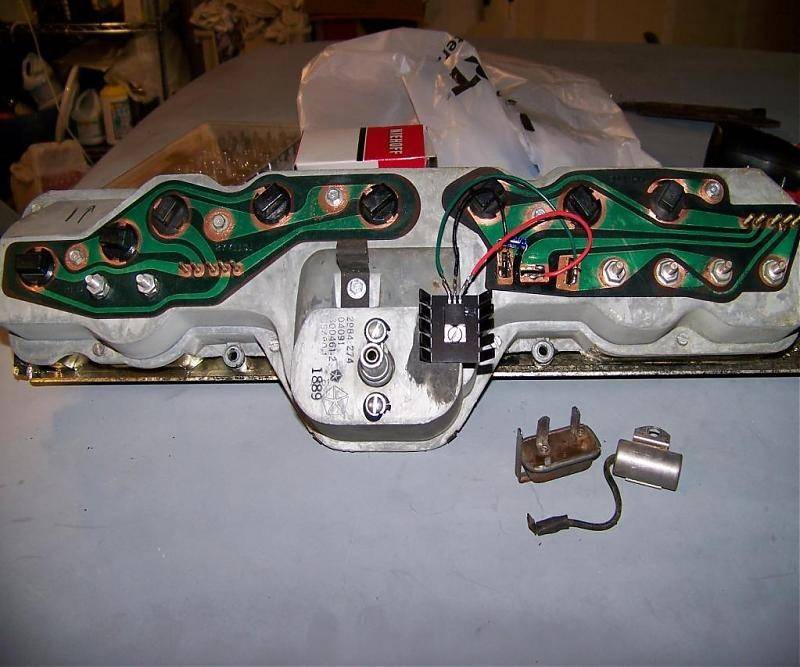

Anyone ever tried building your own 5 volt limiter? Here's the link to a site that explains it:
Yes, I've done that mod. This is how mine turned out...
