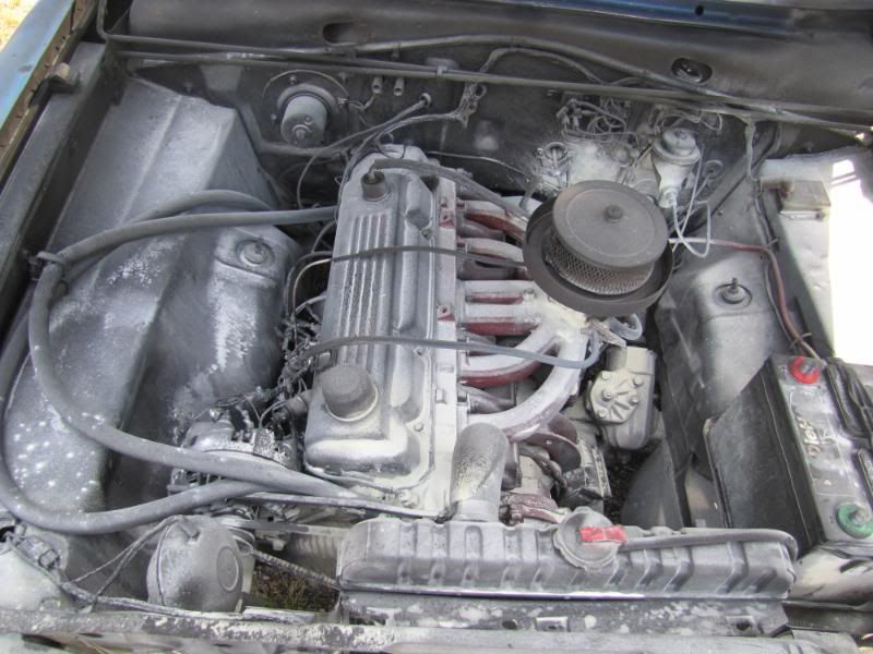

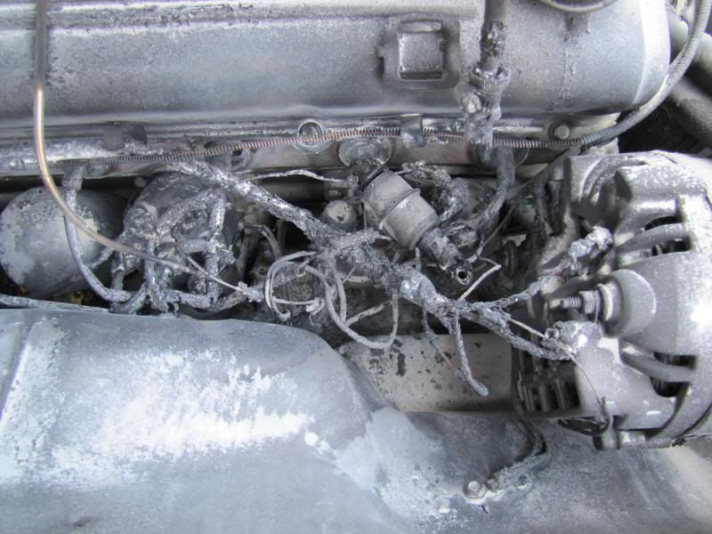

Well the wife's valiant fuel line ruptured, we think it might have be the ethanol in the gas they use around here, and we had a nasty engine fire. I have priced replacement harnesses, and can't even begin to afford a repo harness. I am not comfortable using a 46 year old replacement from a junk car, unless it is my last alternative. I can pick up a 12 circuit hot rod wire harness, from a friend of mine it is a brand new harness, and fix it that way. Has anybody gone this route and used a aftermarket universal harness. What are some of the thing positive or negative about this idea. I am broke as hell, and need the car back up an running ASAP, it is my wife's daily drive. Thanks in advance.
The underhood harness in that car is so simple that a junk yard harness would probably work. I would look it over good and repair any faults before installing it.
This is assuming all the damage is outside the firewall.
When my engine harness melted its self I had doubts about the rest of the cars harnessing. I purchased an EZ wiring kit. Its cheaper than the rest of the kits (pro) because its universal. On the other hand it takes a little more work to install because its universal (con) but definitely give you peace if mind that the rest of the harness is in good shape (pro).
We think that the damn ethanol they run in the gas around here ate the fuel line, until it failed......
The problem is, you may well have some underdash damage. Before you make a decision on how to handle the engine bay, I'd strip out the underdash harnes --yup, lots of work--and inspect it all carefully for damage. Look for damage at the bulkhead feed through, for shorted wires that have fused together IN the harness, such as the big main ammeter feeds. I'd untape part of it to see, then tape back up if OK
If the bulkhead feedthroguh is OK, and no other damage, I'd go ahead with the junkyard harness. You should be able to fix any problems with it. Inspect whatever that car has for a bulkhead connector (not familiar with earlier ones) and be absolutely sure the connector is undamaged.

Hope all that white stuff isn't pkp the stuff is a real corrosive. If it is I suggest you get it cleaned up ASAP.
That was the first thing I did after it was towed home, it was everywhere and it was a mess. Glad that it got put out before it could get any worse, but your right that fire extinguisher stuff is not friendly.

I had a metal line from the carb to just beyond the valve cover, there I had about a three inch piece of rubber hose connected to a metal fuel filter, then another three inch piece that connected to the metal line going to the fuel pump. I had mounted the fuel filter behind the altenator to keep it cool and had it mounted in a way that it would not physically touch the altenator, plus all my connections on the back of the altenator were insulated, just in case. It had been that way for about two years, last year I replace the filter and the car has been on several 4 hour plus trips without a hitch. As a matter of fact we had just gotten home from visiting family down in Tenn. the day before and that was a 4 hour drive averaging 22 to 25 miles to the gallon. It was a freak accident, my poor wife was coming home from the grocery store when it happened, she has a bad fear of fire and she has been a nervous wreck ever since this happened.
how much rubber fuel line was on it?

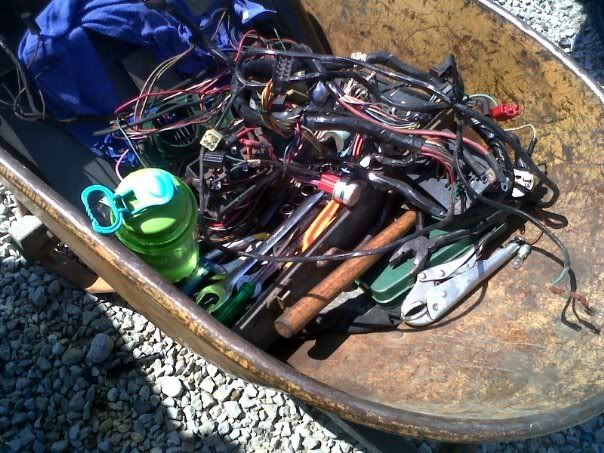

Scored a harness from 73 1 ton Tradesman Van, a lot of good wire and connectors for the voltage regulator, ignition module, a fuse box and the multi-pin connector for the back of the dash panel.....
