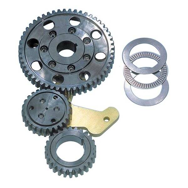

I've met automotive uneducated folks who thought the whining sound of my A 833 4 speed in first gear sounded "like a blower" ... :lol:
No dot's... but what's that crazy whirring sound? lol.
That's the sound of a Chevy, all the Chevy guys in the late 70's and 80's had a gear drive. lol
I've never used a gear drive, good true roller or Jesel belt drive for me. I really like the Jesel.
