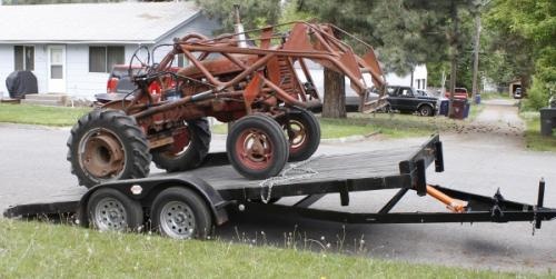

I bought this used, and modified it for tilt. It's a little light capacity, I would not want to tow "very far" a big 4x4, but it would be OK for short trips, IE "dead on road" to get a rig back into town. Even so it weighs nearly 2K empty
http://www.forabodiesonly.com/mopar/showthread.php?t=273175
This only has a 16' bed, and it still can load a full size old Ferd.....
attachment.php
