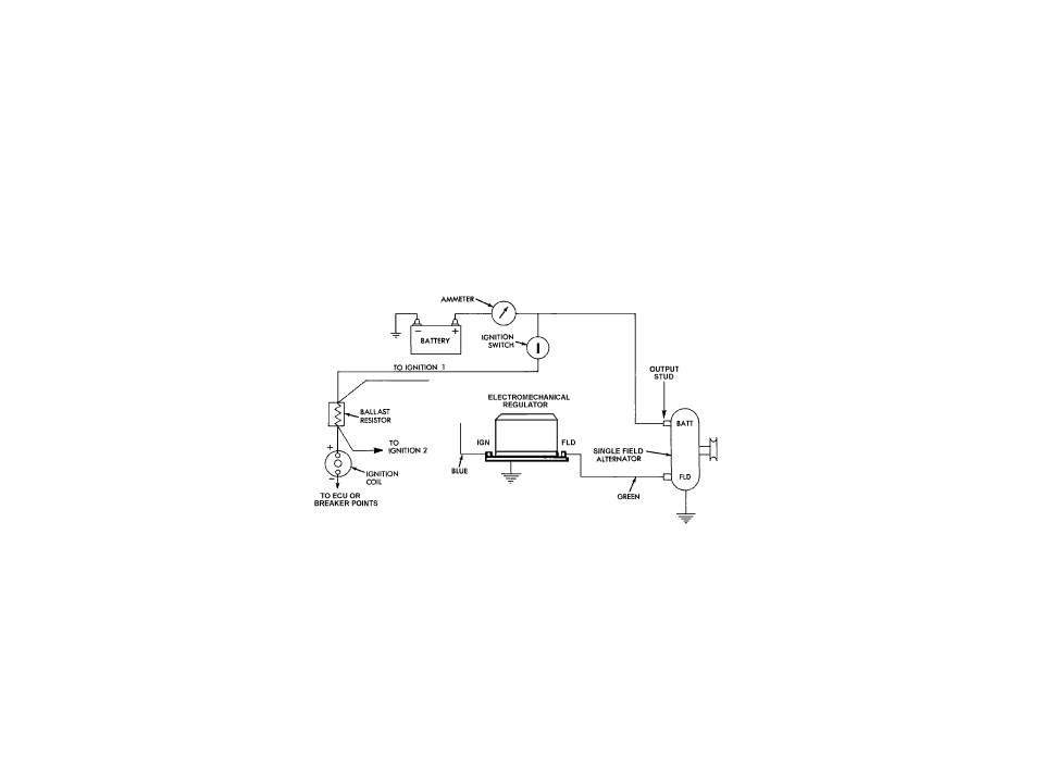

Unmodified Wiring Diagram

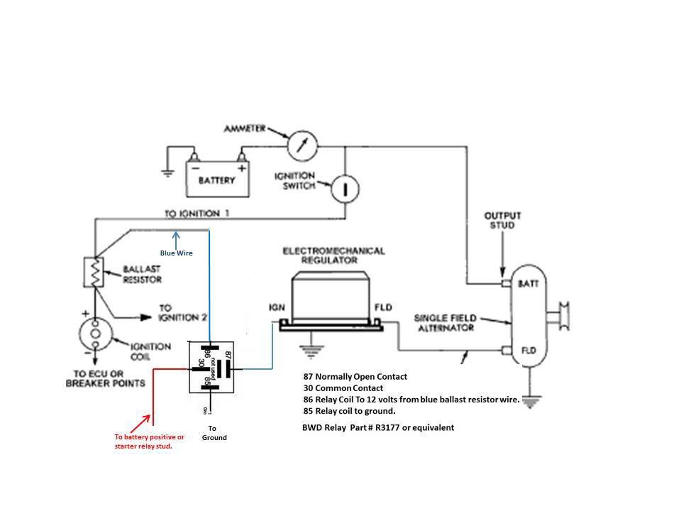

If you can get your hands on a cheap relay (Advance or Autozone sells them for under $10.00) BWR R3177 or equivalent you can try adding this modification. Essentially it will feed the regulator with full battery voltage (which is what you want. Just make sure that you have good grounds and it should work.

Not to worry, the electronic regulator that looks like your old mechanical will connect like your old one but it's designed to work with your single wire grounded field alternator. If your wiring is OK (see the diagram I posted above) it should work fine, let me know how it turns out. Good Luck
