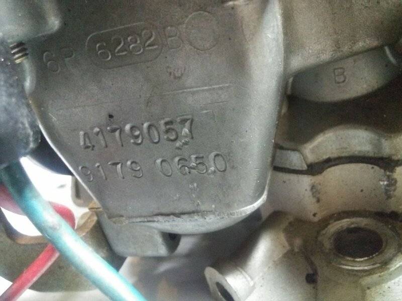

Looking to see if anyone can give me some info on this carburetor. Is this considered a holley 1945? It is from my buddies 1975 Duster. And it looks to have Commiefornia emission garbage on it.
Pics
Carburetor is a Holley 6145, a later version of the 1945. Chrysler part #4179057:Holley #R9179 Date of manufacture March 1980. Carburetor probably came from a 1981 Dodge truck with 225 engine. It would be nice if you could replace it with the earlier Holley 1945.
Screw that. LOL I'd put a Carter BBS on there so quick, it's make your head spin. I caint STAND the Holleys in e slant. They give nothin but trouble, IMO. Even the early ones. Course the best thing would be a sooper six setup. JMO.

This is what was on his duster he just bought 3 days ago, Ive been given the wonderful task of sorting this car out for him.....
Anyway, the plastic the top piece of the accelerator pump keeps getting stuck on the on the cylinder shaped wall that it slides up and down and will not return to top, so you get one use of the accelerator pump and it gets permanently stuck. In California his car would be emission exempt as it is a 1975, California rules are 1975 and older are exempt.
