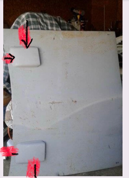

hey guys! Trying to put scoops on a stock hood, for my H-code Cuda restoration
Can anyone please help with sending me the dimensions from mid-scoop to edge as shown in the directions below?
Thank you for your time and consideration!
Back of hood to center of scoop is 6”3/4. Side of hood to center of scoop in the front face of scoop is 11”1/16. Send me your cell I can send you pics if that helps.

Just look at the underside of the hood bracing. I’m assuming that there should be reliefs in the bracing that will get you close. I’m making that assumption based on owning a 69 cuda in the past.
