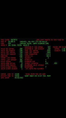

Hey how's everyone doing? .....so here the deal i have a 360 magnum that I been messing with and I just received my 904 trans with trans brake and reverse valve body i am running a danna 60 spool Detroit locker (yes I know overkill) any way need little help picking a right stall I'm thinking a 2500 to 2800 but few people told me look into 2800 3500 just would like to get some other input.

How much gear in the rear, how heavy is the car, what is the cam duration @.050 Any idea what the torque curve of the motor is? a 10" out of the box 2500 stall would be a good guess, we ran them 100 years ago on a plain jane street car . Be decent wont make a lot of heat.
A good converter guy would love you to have a dyno sheet.
