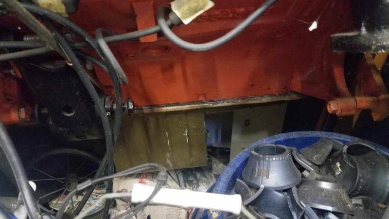

My son got a motor today. It has been stored inside for over 15 years. It is burried in a pickers warehouse. What does the info decipher on the block. I know its a 69 440 , E440. what does the other info in the picture tell,
E440 sideways B
D.LOC
11 22
thanks for your help. Steve

E440 = 69 model year, 440 cu in
D.LOC = ?
D= ?
L = low compression?
O=?
C=?
11 22 = assembly 11/22/68 for 69 model year
That's the best I could come up with.

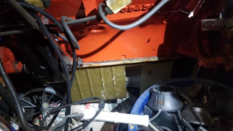

I never saw D.LOC sideways B on any block. It has all ARP bolts and studs including oil pan studs. We will go back next week and pic it up. It is buried in a warehouse. It has a gold SFI approved flex plate. From what we could see and feel it looks to have an 8 bolt crank The pictures you see are from my son holding his camera in among the pile of items on top of it.
The carb looked different I never saw one like it . we held the camera down under it for the damper shot to check for a cast crank damper . It is on an engine stand ready to break from the weight on it. it is complete from fan to flexplate and tall air cleaner to Milodon deep pan. new power steering pump and alternator are in place with belts. the distributor was polished an only has one wire that I could see.

I'm fairly confident the L.OC was an early Low Compression abbreviation. There was an A stamping for .020 O.S. cylinder bores. I once had a 76T HP E (cast crank engine) from a police car that had a sideways F mark on the pad. I wish I had pulled a piston and rod to measure before I traded it off. I suspect other alphabetical markings are indicative of other bore over sizes, but were stamped sideways or backwards to prevent them for being mistaken for the letter year stamping. Darksideracing shows B as .010 undersized crank journals but other sites show Maltese cross with an X for rods and mains, RX for rods, and MX for mains .010 undersized. I don’t know if you had planned on tearing it down, but if it has the stock internals in it you may be able to measure and share your findings with us.

VIN should be on the left side above pan rail at the starter opening on 68 and later blocks. That area looks to be somewhat obscure in the picture. From the sound of the hoard, just thankful no one got hurt on the dig back through the pile. Here is the most accurate information I’ve found on big block ID on the inter web. Moparts on the Web - Main Index

We did not see a pan rail number. But feeling up the front it may have the drilled bosses for a M-code car. Would the OTC block have these mount holes?

It is definitely a built motor all the bolts head and flex plate are ARP. it looks like they bought a long block and added an intake and manifolds to install it in a street car. From what we could see it looks like it came out of a race car.

BTW...is there a notch cut into the pan or is that a weird shadow in the picture?
Look at the pictures of the 1969 blocks below from 440 sorce . The drain plug in the block location? and the strengthening ribs?. The drain plug looks simular to the later cold weather industrial blocks. The last picture is of the industrial block it looks close but it is different.

The block above looks close but its not. There is no casting numbereither
I just noticed after you mentioned it that the industrial block has a notch in the pan rail as you noticed. But this block is still different. The webbing is totally different

Appears to have some kind of composite pan gasket?
