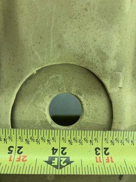

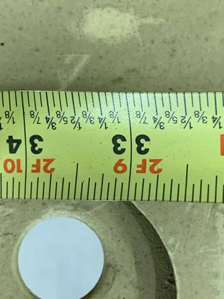

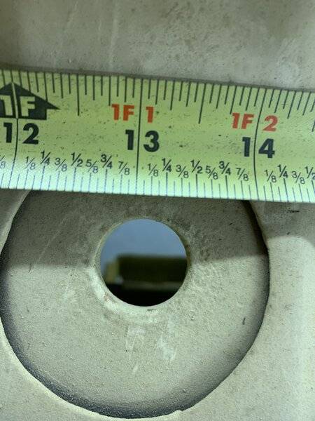

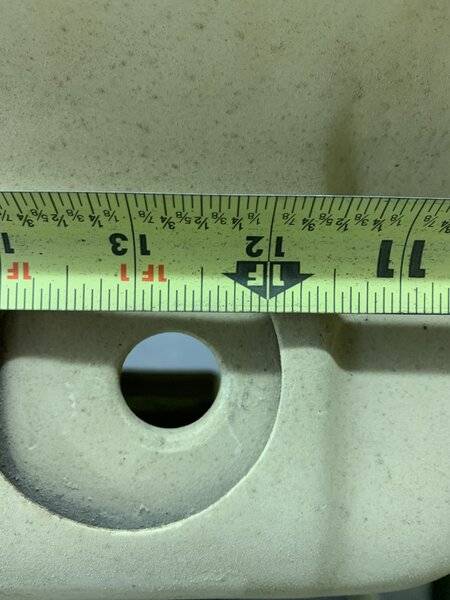

I went out and measured for you these are hard to get exact but they are very close. I took these photos straight on as possible I would weld in the shock tower then do the inner fender part as it welds directly to the shock tower.
this is the left side from firewall at the park brake cable hole.
this is the right side from the small recess at the hole for blower motor.
This is the right side from radiator support where radiator bolts.
Left side from radiator support from where radiator bolts.
this is between the shock towers.

Your most welcome I did edit the wording for the first pic I said speedometer cable hole but it’s in fact the hole for the park brake cable.
