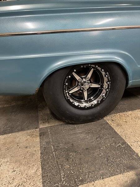

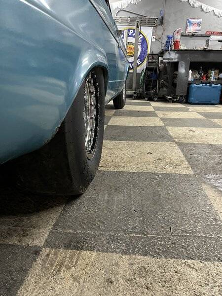

My axle is 55 wide. Wheel mount to wheel mount. I run 15x10 6.5 back space.
Thats an epic fitment, obviously tubbed but did you also have to do work to the outer side of the tub as i am finding that to tuck like you have my rubber will hit the outer side of the tub as it steps in from the quarter panel.
However i am only using a 275 on a 8.5inch rim with shortened diff and spring offsets
