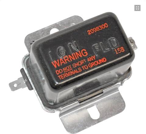

I’m having some confusion regarding the VR again, because I’m looking at some original VR’s and some are adjustable, but I don’t fully understand if mine is, or how would I exactly know it is? What is different on it
There are purposefully adjustable voltage regulators and ones that are adjustable but only to correct manufacturers errors.
This is an example of a non adjustable electro mechanical VR. Note that it looks like the one you have now and it has the wire would resisters underneath it.
This is an example of a non adjustable Electronic version of the one you have. Note there are no wire wound resisters underneath. It also looks like the one you have now.
This is also a non adjustable electronic version of your VR, it does not look like yours but will work just fine.
Adjustable versions exist and have a place to put in a screwdriver to turn a screw that will change the voltage set point.
You do not need one of those. Any of the ones above will work fine.

I’m looking at some original VR’s and some are adjustable, but I don’t fully understand if mine is, or how would I exactly know it is? What is different on it?
You have an original, non-adjustable, mechanical voltage regulator:
img_1500-jpeg.1716330787
It looked like this when it was new:
An original, adjustable mechanical voltage regulator looks like this:
Older regulators are "mechanical," because they use sets of physical magnetic coils and electrical contacts, which move, in order to rapidly turn the alternator field coils on and off, which regulates the overall average voltage, but which creates a voltage that varies from one millisecond to another.
They work fine in their original applications, but, since they involve physical objects with mass moving through space, are inherently prone to wear and ultimate failure.
Modern regulators are "electronic" or "solid state," and have no moving parts.
They work through electronic components, provide smoother regulation, are less likely to fail (provided they are made well), and are cheaper to manufacture in the modern era.
Yours is mechanical and could be bad. It could also be fine. One way of testing it is to replace it with one that works. (In the old days, these were "toolbox items" at the junkyard – things that you'd throw into your toolbox, and, in a sort of a "Don't ask, don't tell" exchange, you wouldn't cop to having them, and the yard owner wouldn't care that you took them. Every single car had one, and any sensible person would replace a bad one with a new one, so they had very little value, but were generally useful if you needed to troubleshoot a problem like yours.).
Nowadays, if you don't have one, you'd need to buy one for fifty bucks, unless you've got a buddy with a good-running MoPar, in which case you could just swap them out and see whether your problem goes away.
