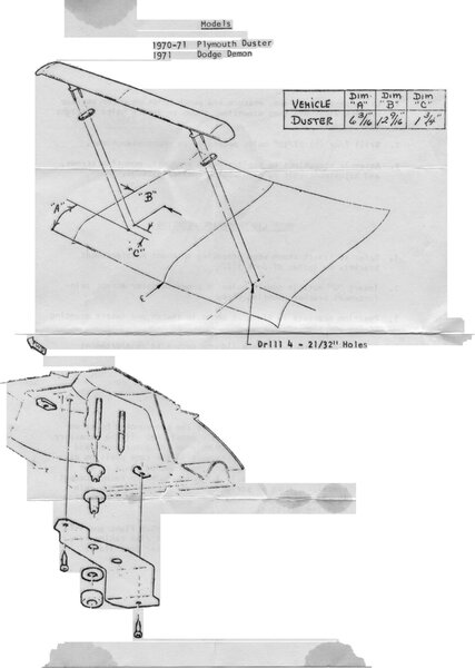

First buy the inner brackets and mount them. Then take the wing and make sure the studs fit the bracket spread . The holes for the wing in the brackets should be 36 inches apart factory. Or the measurement of the aftermarket spoiler your using. Then using the brackets as a template drill the holes.
If you don't have a trunk for a spoiler The small phillips screw holes for the bracket are also 36 inches apart or your stud spread, You will need to cut the holes for the bracket. Always use the inner bracket or the spoiler will bent the sheet metal . The bracket holds it firm from rocking.
