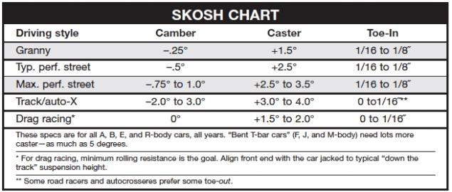

This probably isn't your problem but this is the new spec that your car needs to be aligned to since the old spec was for bias ply tires.
