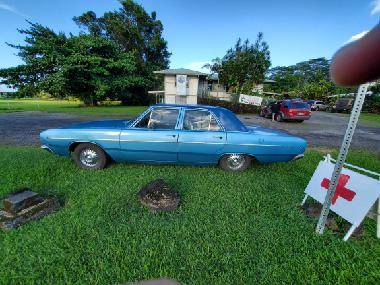

I just got home my wife's 1968 Dart 4 door barn find. Has less 25k miles on it! We live on a 2.5 mile dirt/lava/cinder road in Hawaii. I will post a pic in a sec. Clearly, the springs are sagging. It's a four door, and I have four sons, all of them massive boys, 200 pounds each. Yes, they all are looking at NFL careers LOL, so, with me, two boys and wife, it's a load. Put the food in the back for the run to da other side of the island and beach day, it's scrunched down low! I would like to keep a fairly decent ride quality, this is not a race car, it's a daily driver for my wife, from the farm to our clinic and back about 4 days a week. So it will see some easy miles on it basically, except our bumpy, but not too bad, dirt road. I mean, a prius and a water truck can make it to my place. It doesn't need THAT much clearence. In the pic I will post here, it just got off the boat from Molokai, and has all the tires and a bunch of parts in it. It also has about 300 pounds of horse feed in the back seat. So I am wanting some kind of HD spring, and I might go up a size on the torsion bars as well. So for ride, reasonable ride height, longevity, spring, torsion bar and shock suggestions?
