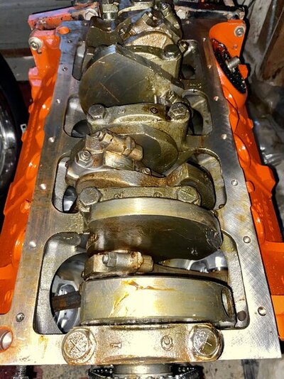

“908” LA 360 crate motor out of hibernation after 15 ish years!
Going in the Demon after full teardown and inspection.

Rod bearing/journal clunked against crank counterweight when installed.
Since been remedied,
No damage to bearing.
The quality of these parts are good but the workmanship lacking.
So far not great but could be worse from some other tales of these blocks.

Next will be crank and rods go back in to be torqued since I have gone over them closely. With crank polished and mic’d and plastic guaged and rods/pistons rechecked, they will go back in after thorough block cleaing.
I will install a pump and pan to prime oil with break-in oil for assurance everything is oiling.

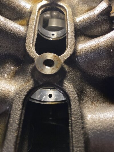

Did that come with a flat tappet cam? It looks like it has the bosses to run factory roller lifters. Is that part of the plan?
Depending on the year (from like 85-93) mopar had blocks that were LA blocks but had the spider mounts and bores for OEM rollers... i have a 318 like that and am trying to find a 360 right now :(
I think the 360’s with roller were mostly in trucks. Not sure.
Lots of 318’s available because of the 5th ave’s but not too many 360 rollers around here.
Yup, my 318 was a truck motor.. which sucks.. i wish it had the car mounts not long truck mounts

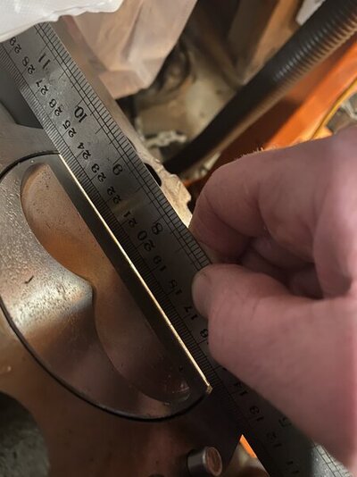

Quinn Forbes - I would like to see a photo of the deck & pistons.

My calculations tell me Im in the 9’s for compression due to the pistons at top being in the hole a c hair.
About .024 in the hole.
