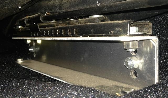

You don't need to buy the SCAT adaptors, or even Summit's brackets. The mounting brackets are a piece of cake. All you need is some 2" by .125" angle, that's all Summit's kit is.
This is a picture of one of the tracks in my car with the same exact Summit seats, using the stock hole positions in the floor.
attachment.php
Everything fits no problem. The seats sit up a little high, since that's a 2" raise from the floor, but its functional. You can probably lower them down about a 1/2" from what I have here if you have a 4 speed car, on mine the side bolster on the drivers side seat will hit the 4 speed tunnel if you lowered it more than that. On an auto car, and the passenger seat, it wouldn't matter.
It's a little hard to tell in this picture, but the front of the seat only has about 1/2" clearance on the 4 speed hump. But I've got short legs and a 4 speed, so for someone taller, or with an auto, you could mount the seat much closer to the floor. At 5'8" I still have room to the roof, so one of these days I might modify the brackets a bit, but I don't have to.
Hey thanks 72blunblu! That's great info. What grade/size hardware did you use? Just curious. Yea definately gonna go that route. Little work but save a lot of $.
Thanks again
Kyle is this what your lookin at doin?
Just the stuff that came with the kit, nothing fancy. Probably only grade 2 stuff. 5 would be better, but 8 would be overkill. Ultimately its still just bolted to a reinforced section of floor pan.
Even still, the minimum yield on grade 2 stuff is 57,000 psi. The studs on the original seat tracks aren't grade 8.
