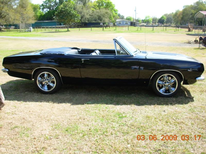

Here are a couple of pics of before and after the ESPO springs. The first one is before ESPO and the second one is after ESPO. The original shock of the difference today is a little less than yesterday and I think it will be fine. I am definitely not going to pull them off and send them back, it is not that bad!!!!! The tires are just shy of 26 inches but they are 9.5 inches wide that is the reason for the added height, to keep them under the fender in the well.
it will settle, that looks more than 1" !! ... did you tighten all the bushing bolts with the weight of vehicle supported by the springs( jack stands under the rear axle, not the frame ! ) ??? ...

re-tightened the bushing today as suggested. There was a little difference of may a 1/4 lower. I think it will work out with time. I am going to lift the front a little if it doesn't settle some.
