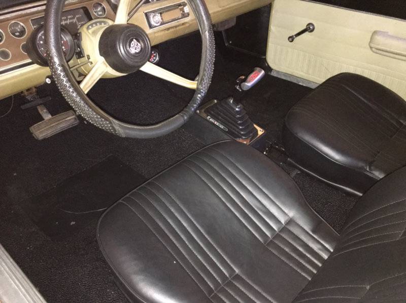

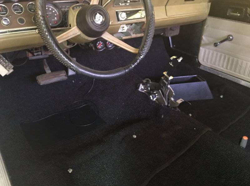

I was wondering if anyone could show me a picture or explain about where the heel pad should be during the time of replacing the front carpet. I have pushed the carpet up as far as it will go and it still seems like the heel pad is still not far enough up, I know I can trim the top which will allow the carpet to be forced higher up but just would like to see pictures of your location.

What I also noticed was that the seam location was in the same spot as mine, on the sill plate there are 4 screws and the seam on the front carpet seem to be between the 2 and 3rd screw if that makes sense...

I just put a mat over mine, but I think that’s we’re the heel pad is supposed to lay.
75 duster. My carpet (Trim Parts) came with the pieces of backing pad underneath in foot areas. That helped determine where it need to sit.

Put your foot on the gas pedal and mark where your heel hits. you want to be 1" or more inside the heel pad.
but generally 1" to 3" after the curve of the firewall to floor. closer to 1" is better for your heel that is resting on the gas pedal and pad here is a parchment and an off white one we made and they are going on a sewn up carpet set this week that's going to Finland.
