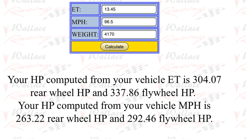

did you mean 395 crank?
295 looks to be 14.8@4170
what iam i missing
Wallace calculator:
The moroso calculator shows 96.5mph to be enough for a 13.45 ET.
