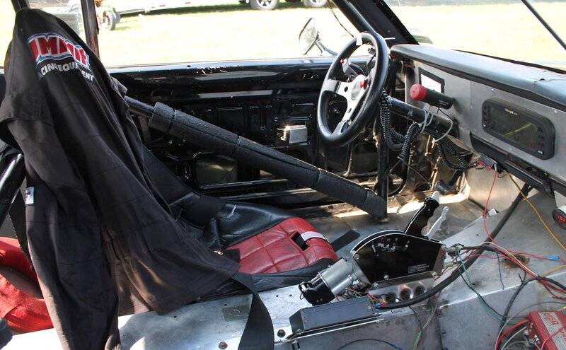

Well since I’m sitting out this weekends three 15000.00 races at Keystone because of feel like 100 degree temps and a chance of rain tomorrow I finally checked my RacePak readings. After running 6.07 all weekend it slowed to a 6.12 Sunday first round and a touch slower the second round. I thought either spinning bad or transmission issues. Well the RacePak looked good but here’s the readout before my battery went bad Friday night. The dip (green) shows it down to 11.6 volts till I floored the car.

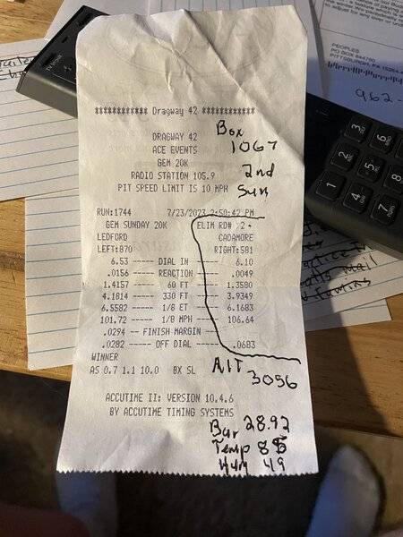

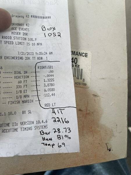

What did the 60 foot show on the slip?
Bad on Sunday
Friday
1.3225
1.3303
1.3263
Saturday
1.3245
1.3246
1.3249
Sunday
1.3282
1.3580
Remarkably consistent except for that last pass.
Sure looks you are right. Accounts pretty much exactly for the number you saw
Double the 60 foot difference is what I usually seem to see, but you are a good bit faster.
So 6 numbers +- total with the 60’ 3 off
I had to look at my slips again to make sure but Friday we had a big tailwind. (8-10 mph) Saturday normal day then Sunday we picked up a so so head wind (6 mph). I took the wind numbers from my phone weather app. Wind changes quickly at this track. Gotta keep an eye on the flags. One got ripped off in Thursday night storm.
