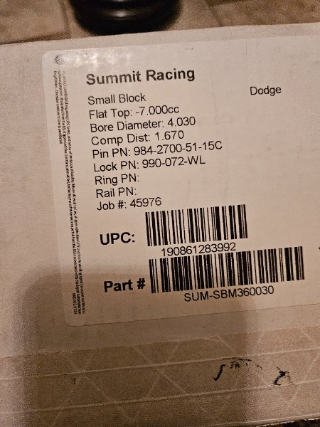

Got the pistons figured out SUM-SBM3600-30 should give a nice bump up in compression and still be street gas friendly. With a 65cc head I should land at 10.2. @Car Nut Thanks for the EARLYP discount code, saved a few hard earned bucks.

Using the stock deck height, I get .017" in the hole at TDC for those pistons. Oughtta get some decent squeeze.
Thats the same number my shop came up with. Question is how close is the actual deck height to the published, and are they 60 or 65cc chambers. I figure either way we can tweek with gasket choices.
I wouldn't. I'd go with the .028 and let compression fall where it will. It's not like it's gonna detonate with quench AND aluminum heads. Ain't happenin.
In fact, I'd zero deck that bad boy and run the .028 gasket.
