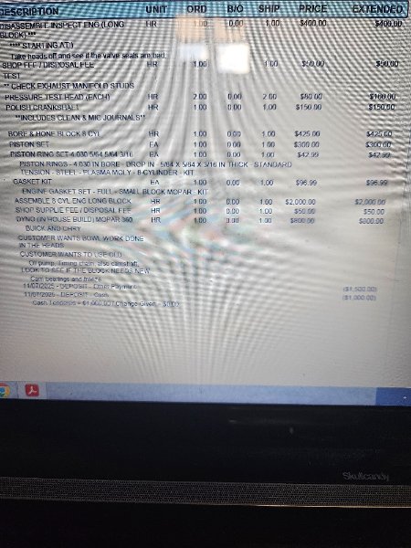

Just got back from the shop. Lets see if I can keep it all straight. Block needs to be rebored and honed. Which means new pistons too. The good news is that they were dished pistons and no where near the 10 to 1 compression I was told. Now I can put in flat tops and get to my goal. The crank has not been turned so that can be saved, the cam looks good too so with new bearings I should be fine there. They haven't had a chance to pull down the heads yet so still a question mark there. I asked them to take a look at the bowl work that was done previously and see if there was any easy hp there.
I was thinkin it might have been toast and another factory roller cam 360 is tough to come by. Think I got pretty lucky I didn't run it longer.

Just got a workup sheet from the shop and I thought I would share so yall could see current prices.

So I'm seeing port matching but no bowl work or anything else. What do you think?
