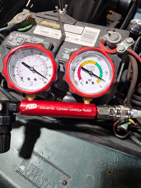

Ran a leakdown test and it looks pretty good.
Did a compression test and they were all within 10%. BTW the engine was cold. Got most of the top pulled apart and ready to take off the intake. Ran outta time.

Also, just because the ring seal is good compression/leakdown-wise, doesn't mean the oils are OK, or that 1st or 2nd compression rings aren't flipped.
Just some things to keep in mind if the cause turns out to be evasive.
