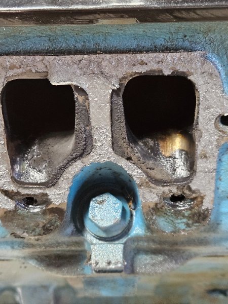

Not that this is related to the issues that pushed you to pull the engine, but…….. is that braze in the right exhaust port?

My bourbon buddy!! Thanks for helping me pull the motor. I'm afraid you are gonna be about right on the bill. Hard to be patient and gather all the facts. Adam says looks like rings and bearings were replaced and no machining other than some head porting. Assembled a dirty motor and the fresh oil broke some stuff loo on top of that. Sounds like a likely scenario. He is also guiding me toward aftermarket heads. These have the original 1.88 intake valves.
