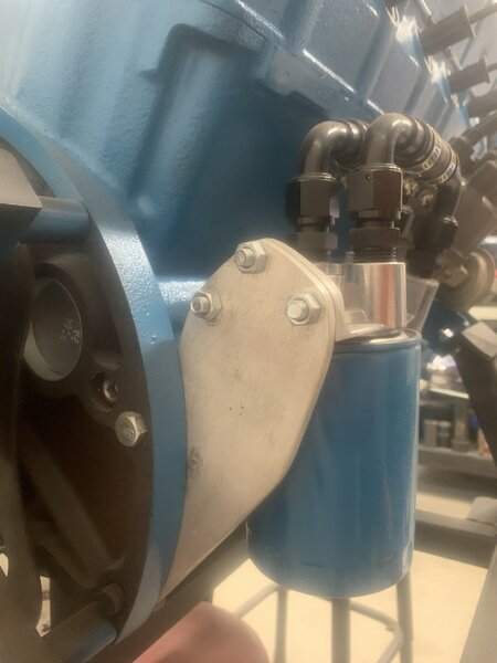

I like the idea of a remote mount so much, I did my own take on it. I had a similar setup on my race car and it worked very well. BB 440 has similar filter mount and made filter changes a mess. I bought a remote mount kit from Summit (I think) and here’s what I ended up with. Goes in the A100 in my profile pic.
I did the same exact thing on my engine. My setup differs only slightly from yours. Next I do it, I will mount my filter to the bell housing flange similar to yours.
