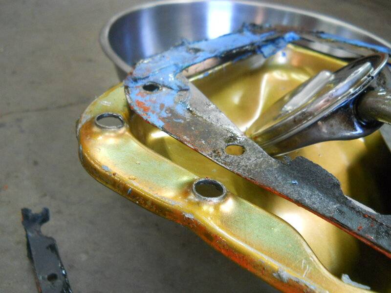

The amount of seal-a-cone I have removed from INSIDE the oil pan/block is terrifying. I’ve never seen any of it break off and get into the pickup, but it sure doesn’t make me feel all warm and cozy thinking about it.

Spent a couple years at a dealership replacing the orange rtv with cork.
