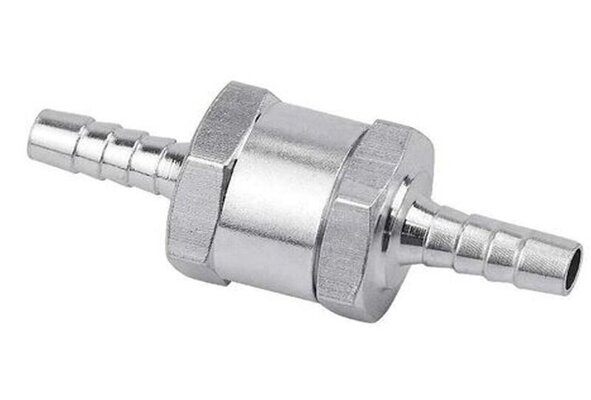

I planned to install an electric fuel pump, but I would like to try an alternative and easier solution : a "one-way" valve (or "non-return" valve) on the fuel line. It's cheap and very easy to install.
But is it efficient? Will it prevent the fuel line from emptying (or will the gasoline evaporate anyway?)..? And where's the best location to install it on? Just before the fuel filter?

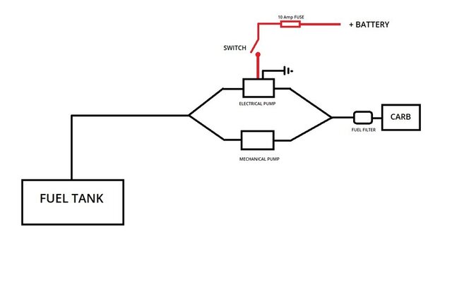

Maybe a parallel installation of both pumps (using "Y" connectors) would be better than a serial installation?
Something like that :
What do you think about?

It's probably just evaporation. Trying a check valve wouldn't hurt. We have had many discussions here about the subject and the only fix people rave about is the electric charge pump. Those that have tried the check valve don't say much about it after it's installed. Here's a link to the pump thread. Hook it up near the tank with fused power and a momentary pushbutton. Electric primer pump for fuel

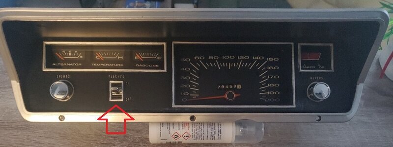

I have a '68 Valiant instrument cluster installed into my Demon, and it has a very nice on/off switch ready for use (initially the flasher switch). Would be perfect for a momentary fuel pump boost. :)

not-running electric pump does block the gazoline coming from the mechanical pump?
No, and a 198 Slant just sips fuel. I even run that set up on a 472 Dual Quad Hemi. But I will say with all 8 barrels open it needs the electric pump on feeding the mechanical pump.

Many years ago I started to put together a fuel system similar to this. My plan was to run a second 3/8” fuel line that started inside the tank. My plan was to run a fuel pressure sensor in the original fuel line. Once the pressure dropped to a certain point the electric fuel pump would energize. The fuel line with the electric fuel pump also had a check valve in it. My reasoning for dual fuel lines was that if the pumps were in series and the vanes in the electric pump could block or part block off the flow of fuel. The other thing is that the check valve would stop any fuel from the mechanical fuel pump to back feed through the electric fuel pump while the electric was not running. I never followed through with it though and I may have over complicated it.

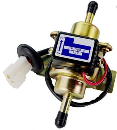

My pump :
Isn't it able to aspire gas from the tank? It's given for 3-5 psi and 30 gallons per hour.
And if the mechanical pump is just behind it, the combined suction of both pumps won't be enough to quickly fill the fuel line toward the carb?
Any pump should push through the following pump, or pull through the upstream pump. I ran a REAR mounted NON energized pump on the street for years. ALL pumps have check valves. Whether or not they properly "check" is due to design, quality, dirt and debris, and wear
TWO things (or more) have changed since the old days. Quality of components, and the chemistry of the fuel. Alky gas evaporates, vapor locks, and boils more easily than the fuel we knew as kids
My pump :
In theory, that should work. I would mount the pump near the tank simply because that's the way it's designed to work.

called a check valve ........

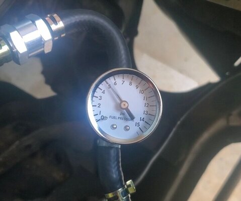

Ok, I tried a check valve, and the result isn't very probant.
I installed a pressure gauge onto the fuel line (just between the rigid line and the fuel filter) and the pressure with the engine running is good : 5 psi.
But when I shut the engine, the pressure goes down from 5 to 0 in a one minute delay.
If the fuel pump has integrated check valves, is this pressure drop normal?

I would say losing that pressure in about a minute could be considered normal. Some pumps leak, some have actually tiny bypasses in the valves. Otherwise the line , hot, between the pump and the carb will heat and raise pressure, and force fuel past the needle and seat
