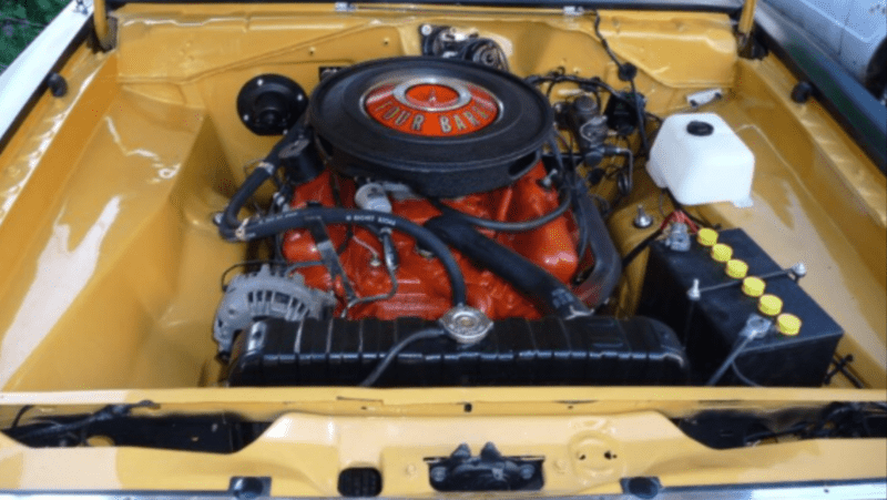

opinions welcome on build.
Where that 427” mentioned previously ended up.
Not a 4” crank though....... 4.125”.
Reminds me running Super Stock on the Vogue tires
Darn Z-11 Chevies
Dyno Don (who did our chassis dyno as well as his chevy had a 62 F/X others like Hayden Proffitt had 63s )
roll out and not hit the secondaries till half way through low gear
I’m not going to give out the power numbers.
But, I will say the hp/ci improved ever so slightly with the new combo.
Why the big motor? He wanted more power....... and my suggestion was more cubes would def make more power, and that another/different set of expensive reworked stock heads may or may not make more power.
He was looking for tens, and I felt this was the easiest path forward.
It’s the fastest SB FAST car........ by a bunch...... so i’d say it turned out pretty well.
