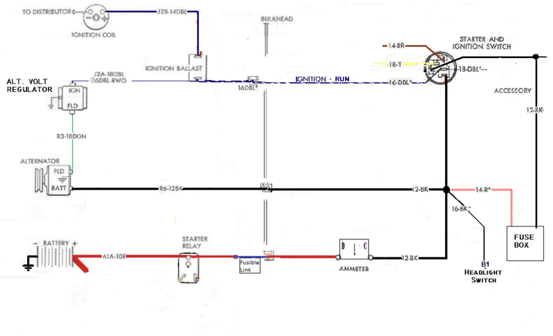

Let's back up here and start over somewhat
1...Smoke is NEVER good
2....You may either have a wire crossed or somehow hooked into the VR / field circuit, OR the alternator field may be partially shorted and drawing too much current
If you do not have such, wander over to MyMopar and (free) download yourself a factory service manual. In section8 under alternator is a procedure to measure field current draw of the alternator. We need to know what that is.
Do that BEFORE you install another VR
3...Next I would try wiring in the new VR "direct" temporarily, that is, wire a new temporary wire direct from the VR F to the alternator field, and "temp" a wire direct from the VR IGN to the battery. Disconnect the VR IGN from battery when not running.
Test the output and voltage/ etc as to battery voltage, and alternator drop between alternator output and the battery +
Make CERTAIN the VR is grounded.
4...Finally if this all works out, no smoke, proper system voltage, etc, you can start backtracking and implementing te thing back into the system, carefully checking wiring each step of the way

I also added a parallel 14GA wire from the output post on the alternator directly to the Ammeter. I bypassed the Ammeter by connecting all wires to one terminal. I ran a ground direct from battery (-) to the VR Ground plane (chassis). I replaced all the terminals at VR, Alt, and Ballast. I also added a missing ground from the engine to the master cylinder bolt (cleaned), Installed a rebuilt alternator and a new Interstate Battery (fully charged) and tried it again.
OK. If the ammeter is bypassed then you won't know if its charging but this ...
Output at Alternator to Bat (-) @Idle: -0.5VDC (DMM (+) on Battery, (-) on Alternator)
Output at Alternator to Bat (-) @2000RPM: -2.3VDC (DMM (+) on Battery, (-) on Alternator)
strongly suggests the battery is taking a lot of current.

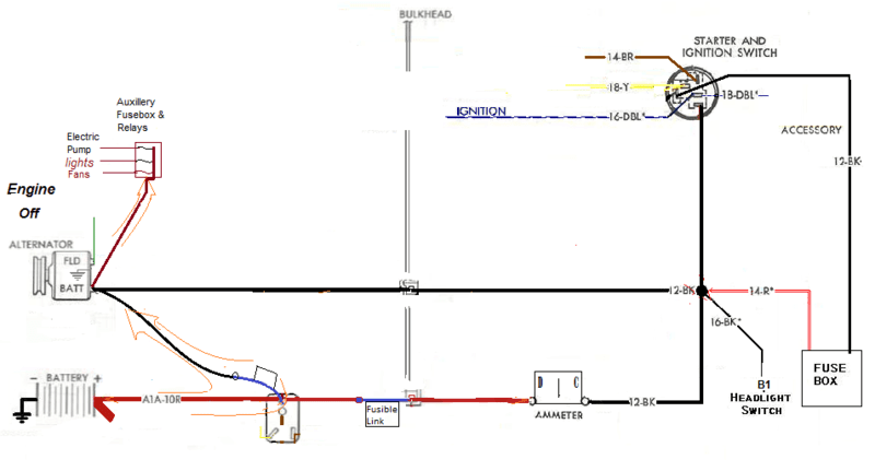

If the electric fanpowered from the battery, move the connection to the alternator. That will reduce the load on the wiring between the battery and the alternator output stud. That wiring clearly has too much resistance for the load going through it.
Original power scheme
Ammeter only shows current to and from battery.
Attach the fan or fan relay to the power supply and only run the fan when the engine is running.
In this example above imagine if the current to the headlights lights, ignition and fans was all going down the R6 wire.
How many amps would be going through that line?
Then if the battery needs charging, how much more current would that be?
If you want to run the fan with the engine off, then wire battery more directly to the fan. Something like this will allow the battery to power the fans with the least amount of resistance.
And batttery charging would look like this
Very good points mattax, I need to focus on the current loads. I'll run a separate fused line direct from the alternator to the feed at the fan relay.
