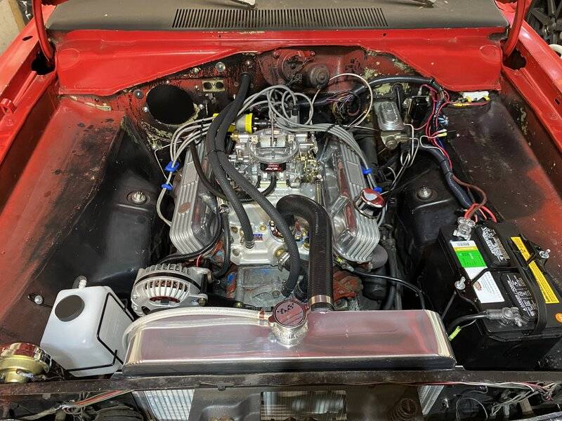

Here’s a picture of the engine bay with their original style VR installed now.

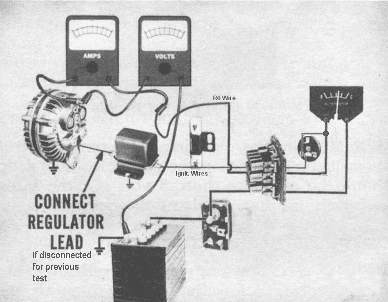

Adjusting regulator.
If the points and connections are OK you can use your home made test ammeter to do the two regulator checks in the MTSC.
A tachometer would be helpful, but even without this should get its ballpark correct.
There are two tests; one is to test high load situations, and the other is to test higher rpm, low load situations.
The first relates to the sping tension, the second (which may be your situation) relates to the air gap setting.
Often the book drawings can be a little confusing.
Lets just go over the set up drawing.
For illustration purposes the main junction is shown at the car's ammeter stud. We can alter that to show the welded juntion but functionally its the same.
The Voltmeter is connected between alternator output stud and ground.
The Test Ammeter is between the alternator output stud and the output wire's ring terminal.
If I understand correctly, on your car there now two additional wires at the alternator output terminal.
1. Feed to fan power.
2. Parallel main feed through the bulkhead.
In which case the test setup will be something like this.
You can use either the fan and/or the lights to bring the alternator output to 15 amps for the first test.

Here's the set up with some notes added.
Ignition wires in this case refer to the power coming from the run terminal on the key switch.
While the first test could be done with a carbon pile, for most people the way to add load will be to turn on lights and or heater fan.
Current from out of the alternator will then increase to match the demand. Volts at the alternator need to be very close to the volts at the regulator's ignition terminal or these tests are not valid. (I think you understand that but others seeing this post who have not read the thread or the booklet may not.)
