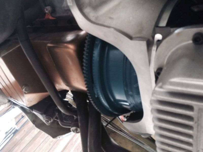

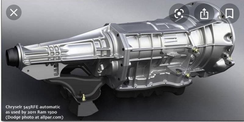

Just be glad you’re not putting this one in. A little more that seven inches has to be cut out. In any case overdrive is great in a street car driven on highways. 2400 rpms at 80 is pretty nice.
On the 727, it is possible but expensive.
The MP draw back....
