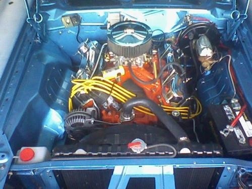

I was in this exact position. The paint under the battery tray was etched away by the battery acid, but the rest of the engine bay was in pretty decent shape. I was gonna just try and do the inner fender below the battery tray, but after discussing it with my body man, he told me I would later regret it if I didn't paint the entire bay while the engine was out. I'm glad I went with his recommendation, as now I am also changing the entire color of the car to this:
Thats a good plan actually, probably better in the long run. Now just have to decide on the colour if I do paint the entire thing, thinking a dark blue colour. But it takes me months to decide on things, so ill be deciding forever on a colour!

Wow the before and after pictures are pretty substantial! Looks really good. I may paint the entire engine bay, easiest while the motor is out anyways.

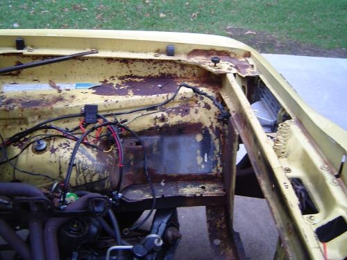

I also had the same problem with battery acid. It looked like a battery exploded at some point in time.
I wound up sanding the entire engine compartment down to bare metal. Believe it or not I found a shade of yellow Rustolium that was a 95% match to the car. I really lucked out.
