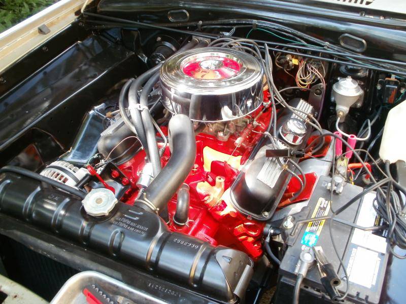

Oh and do yourself a big favor and paint it body color. I was in a hurry to put my newly rebuilt engine in and at the last minute decided to paint the engine compartment. I prepped it and painted it rattle can gloss black. It turned out pretty good but I still catch crap from the Mopar crowd about it. :BangHead: :BangHead: :lol:
Black!!!!! hahahahahaha :BangHead:
OK so now you have to paint the rest of the car BLACK!!!!!!!!
:poke::poke::poke::poke:
