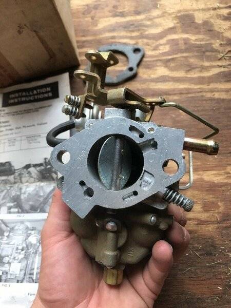

Another workaround that leaves the existing intake in place: In '67 on the Carter BBS, a couple years later on the Holley 1920, the PCV arrangement on the carburetor was moved over to the right (inboard, driver's) side and the pass-thru was completely contained within the throttle body; it entered at an inward-downward angle so there was no longer a need for that 1/4" hole on the outboard side of the carb mount pad:
This can't be surgically done on an earlier carb without ruining it, but there are carburetors that have the appropriate throttle lever for the '60-'66 rotating-rod throttle linkage and the inboard-side PCV port. They were mostly service replacement carburetors meant to fit a range of year/model Slant-6 cars, and one of these would neatly solve the problem for you. The trick is finding one; at this late date good Slant-6 carburetors have grown scarce and expensive. Here is a brand-new one (ad says "225", but it will work just fine on a 170).

There is a workaround: In '67 on the Carter BBS, a couple years later on the Holley 1920, the PCV arrangement on the carburetor was moved over to the right (inboard, driver's) side and the pass-thru was completely contained within the throttle body; it entered at an inward-downward angle so there was no longer a need for that 1/4" hole on the outboard side of the carb mount pad:
