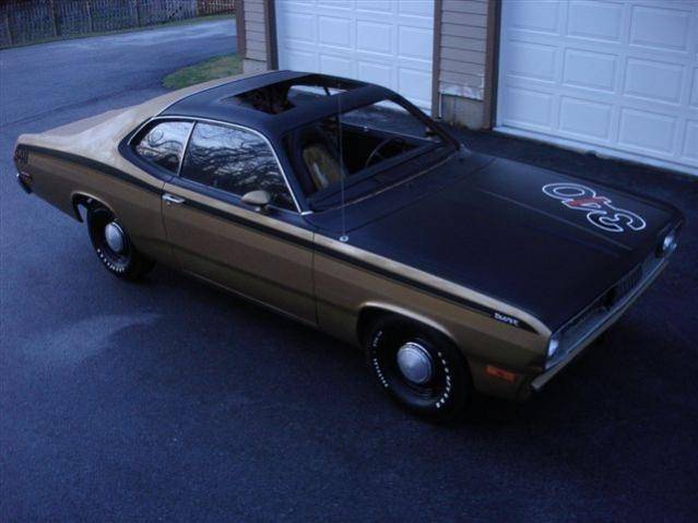

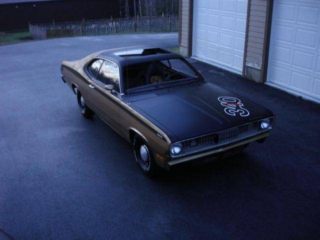

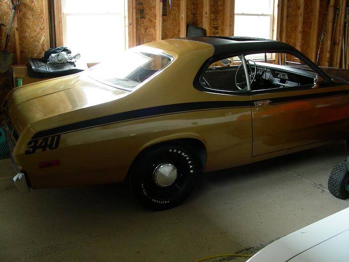

Here's some more pics of it before the weekend, it's almost completly done now after the weekend.
DAM! looks great, love the 340 wedge emblem, if i ever had a duster id do about the same thing, blacked out hood with that emblem8)
I'm now using it for my daily driver, still need to get the sunroof installed and then do the headliner. Front windsheild was installed yesterday and I need to give the trim a quick buff and install. I'm loving it but I think I'm going to take a 360 I have and put a stroker kit in it and also put a 4 speed in it for next summer.
