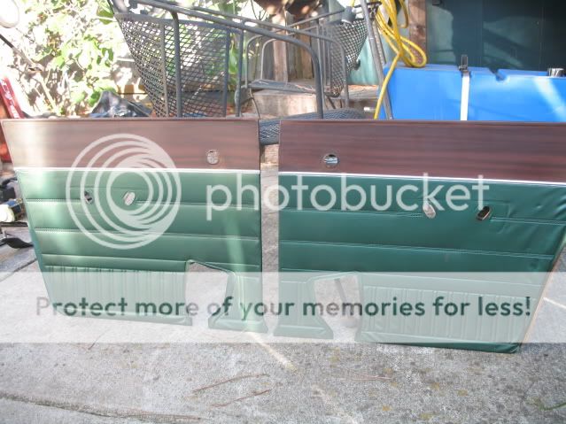

Would like to see what the retractor mounts look like in a later model swinger. I have some spare seat belts and was thinking of converting one of my darts over to retractors. Anyone got any shots with the rear panels removed so I can see how they changed the panel for retractors in the 70's models?
Cheers.
Here's some pictures with the panel off. You can see where the bolt hole is for the retractor is in the close up pic's.
Thanks for that Stan, that was exactly what I wanted to see.
Looks like I could easily do something similar, on an older dart with a little fabrication.
