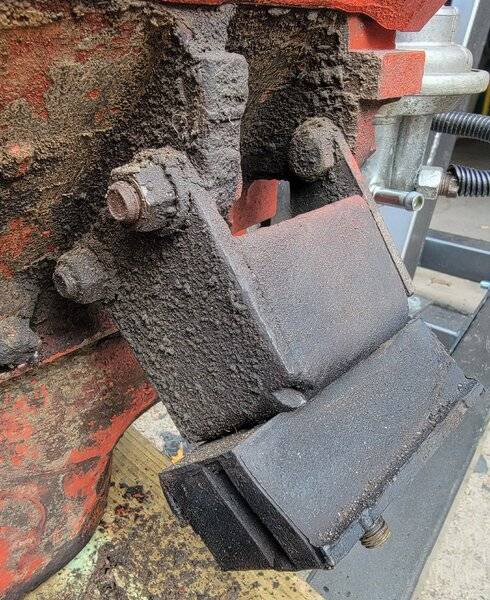

I have a 65 Valiant here that I got in multiple pieces. I am getting ready to set a rebuilt 318 in tomorrow and am trying to figure out which motor mounts I need to use. I have a pile of mounts in the garage but I don't know which ones are correct or which ones are not correct but will still work.
Can you help post some pictures of a stock setup or something OEM from another application that worked? I did a search but couldn't find many useful pictures.
These are what I have found.
The red engine is a 318 that had these mounts on it. It was a '72 engine installed in a 65 Dart. I don't think they are correct but they did fit.
Do those look like a factory set for a 67-72?

Is it true that the engine brackets always mount behind the cast in lugs on the block? It is that way with the big blocks so I thought it might be the same with the LA series engines too.
The block ears are different widths so the brackets only fit correctly one way.

Engine is in, bolted up to the trans using motor mounts that I already had here. The pictures you guys posted helped a LOT.
