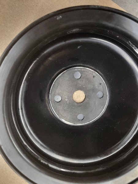

Clever location for the crank trigger. I set up one on the front and it takes up enough clearance to be annoying.

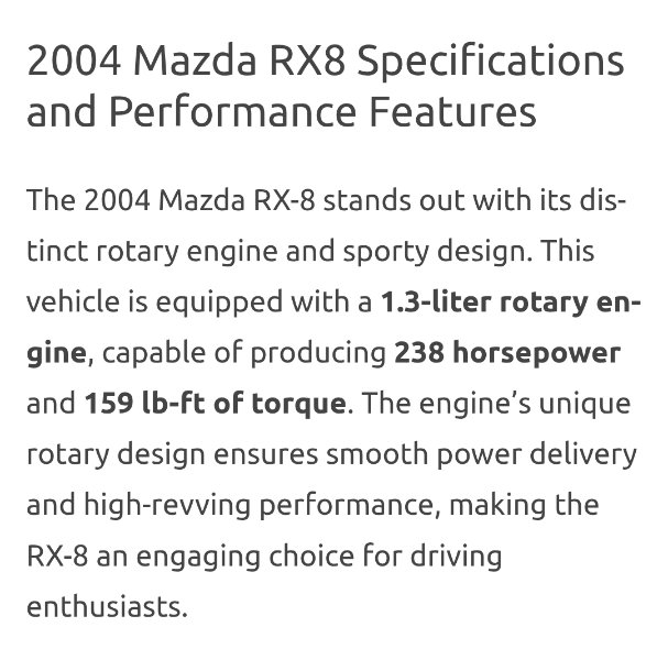

The rotary in the 2004 RX8 is all cast iron. Mine weighed 240 when I pulled it out. My slant weighed 470. So 230 more pounds. But as I said, a lot of parts came out that will no longer go back. Two huge oil coolers, lines and brackets. Lots of plastic, wires, emissions crap, on and on. About 100 pounds altogether. Then when the battery goes in the trunk it moves about 50 pounds from front to rear which restores the balance of the car. As far as power goes, the 1.3 rotary maxxed out at 238 HP-not 400 HP. I hope to get 200 HP from my slant. And the slant will far exceed the torque of the rotary at maybe 250 vs the rotary at 159. The car should be much quicker even with a mild build. We shall see.

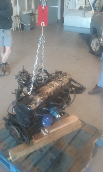

I weighed my slant when I pulled it. 437#. I don't know what to tell you. Did you weigh yours? I'm not leaving it stock. Oregon cam, Gill Welding fuel injection intake, Dutra Duals with Gill Welding exhaust, six LS coils, Haltech ECU, head work, etc.
what did the alloy slants weigh
