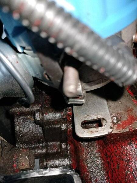

Got to play around with the timing today. With timing set at top dead center on the yellow mark it runs at a much lower RPM and seems more responsive. The only problem is, it's a tooth off. I'll pull the distributor cover off and for example, it's a 6 o'clock. I try and get it to 5 o'clock, but it snaps to 4 o'clock. It's either like the picture below to get it set to 0 degrees, or I have to bury the tab in the block and it's like 15 degrees past TDC. I have my daughters concert tonight, so I'll try tackling it again tomorrow.

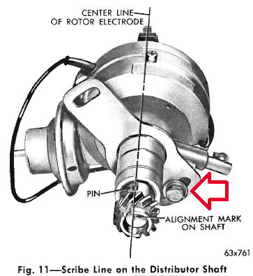

Okay, figured out the problem. It boils down to... I'm an idiot. I didn't realize there was a second bolt on the bottom of the clamp plate that went into the distributor that allows it quite a bit of adjustment. So, my struggle with my own incompetence is just getting started.
Get you a Snap On S9467B distributor wrench. That will enable you to get to the top and bottom fasteners easily. They're gettin kinda hard to find now.
You're not incompetent, an incompetent would still be at a loss w/o seeking the answer/solution or start doing hack things, lots of folks are unaware of the second adjustment slot. You've got it, but DO make sure the mech.adv operates freely, it should turn easily with thumb & finger to it's stop & snap back when released. The OE lube drys/cooks & gets gummy lots of times, just free'd up one on the '72 Satellite 383 I rebuilt the carb on ~a year and a half ago.

I may just buy me a long 7/16 box wrench, heat it up and bend it until I can find an appropriate tool. I see they pop up on eBay once in a while.
You can certainly do that. Just remember, when you get on the bottom bolt from the top, you now turn it clockwise to loosen as viewed from the top.
